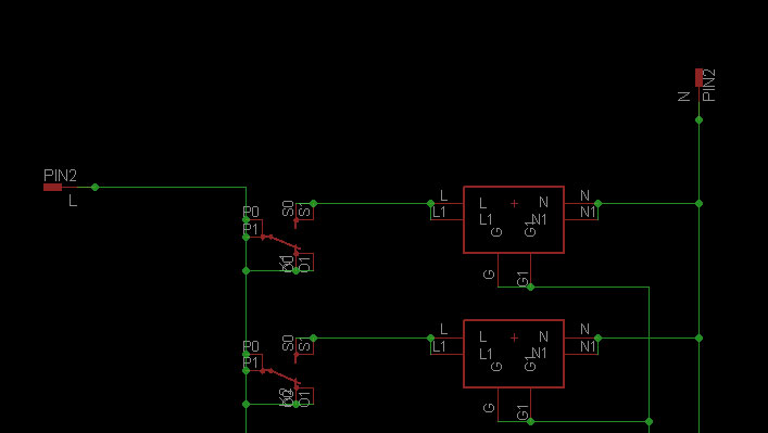

Relays switch on hot.

I can see what the schematic says but if you buy a $8 outlet tester at Home Depot you will see that it says otherwise.
At least on outlets 7 and 8, which are the ones I measured. I will measure some of the others.
