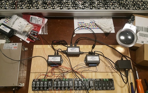

Is there something that would keep a 6 ch Dimming module from working with a Cloud Wifi Hub expansion?
I inserted the jumper on JP1 and added the code to my INO.
void setup():
and used the following as a test.
void loop():
I can see the changes in the android app but the lights do not turn on
I switched the the following code:
With the same results
I attached the jumpered 6ch module to the RA* and ran the I2CScanner.INO just to verify that the address was 0x41 and it was detected there correctly.
I even tried your test code, slightly modified, as I only have 4 channels from that module attached right now.
This is what my setup in the remote room looks like at the moment:
void setup():
ReefAngel.Add16ChPWM();
void loop():
ReefAngel.PWM.Set16Channel(0,9);
ReefAngel.PWM.Set16Channel(1,27);
ReefAngel.PWM.Set16Channel(2,45);
ReefAngel.PWM.Set16Channel(3,63);
ReefAngel.PWM.Set16ChannelRaw(0,369);
ReefAngel.PWM.Set16ChannelRaw(1,1107);
ReefAngel.PWM.Set16ChannelRaw(2,1845);
ReefAngel.PWM.Set16ChannelRaw(3,2583);
for (int a=0;a<4;a++)
CustomExpansion(0x41,a,50);
CustomExpansion(0x41,now()%4,99);
void CustomExpansion(byte id, byte channel, byte percentage)
Wire.beginTransmission(id);
Wire.write(0);
Wire.write(0xa1);
Wire.endTransmission();
int newdata=(int)(percentage*40.95);
Wire.write(0x8+(4*channel));
Wire.write(newdata&0xff);
Wire.write(newdata>>8);

Re: 2nd Dimming Expansion Module
Hummm.
I may not have implemented the publishing of this module.
I have to double check.
Does it work if you use it directly connected to RA*?
I'll un-mount the module and use my multi-meter to check for voltage.
With 0x41 attached to the RA* and the below code:
I get the following:
ch 0 - 0.43v
So, that means the module is working fine as well as your code.
The only thing left is the communication from RA* to the cloud wifi hub.
I have to check, but I'm almost sure I didn't include it.
I'll check it later tonight after I put my kid to sleep.
Yes, the 16ch is confirmed not to be in the publishing of variables.
It would take a change in the libraries for this to work.
I think the best would be to just add this to your own code and it would take a bit of patience to get this completed.
Do you want to give it a try?
I can get the code started for you to test.

Roberto, up and working with lights hooked to 0x41 channel 0 alternating from dim (50%) to bright (100%) every second.

Yes, the code was set to alternate between 50 and 100.
Correct, you can change that code I used for testing to whatever you want including the one you posted above.
don't change anything regarding the millis() check.
The reason it is there is because sometimes, the module doesn't like to receive too much data too fast, so the check is simply to make sure we only send data once per second.
Just add the part where you set the 16 channels to whatever waveform type you want and you should be good.
