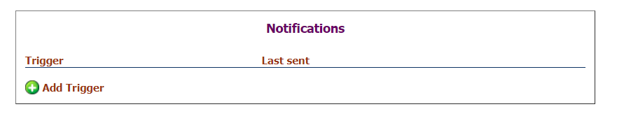

riggeek
- Posts: 113
- Joined: Wed Sep 12, 2012 8:41 am
Re: RA+ to RA*
Here is what I see.
riggeek
Re: RA+ to RA*
Are you getting emails though?
I see it sent an email about 30 minutes ago for salinity less than 32
