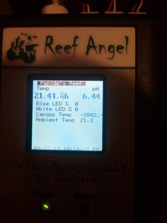

I have some problems with the screen or controller of ReefAngel. Following some pictures:
2012-02-27 22.13.40.jpg (68.93 KiB) Viewed 7242 times
2012-02-27 22.12.48.jpg (51.92 KiB) Viewed 7242 times
2012-02-26 21.34.12.jpg (68.71 KiB) Viewed 7242 times
I tried changing pde and reload it ... reboot the device several times .... disconnect and reconnect temperature sensors....but nothing to be done each time a different problem makes it unusable ...
What happened? any suggestions?
Thanks Paride

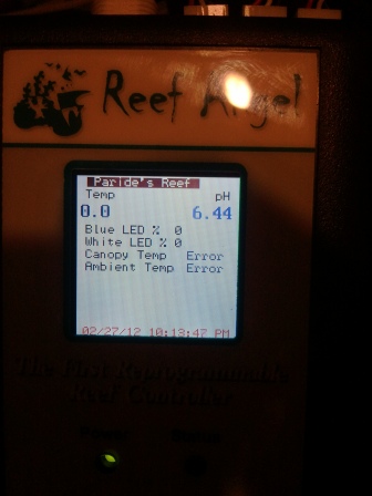

When the temperature probes aren't connect the screen appears as in Figure 2012-02-27 22.12.48.jpg (Temp 0.0, Canopy Temp Error, Ambient Temp Error)

I reboot without probes connected. The screen remains as previously described in Figure 2012-02-27 22.12.48.jpg
Re: Problem with Reef Angel - Screen or Controller
There is nothing wrong on that picture.

I reboot with one probe connected. After few seconds some noise from relay box and the screen appear like in figure 1.

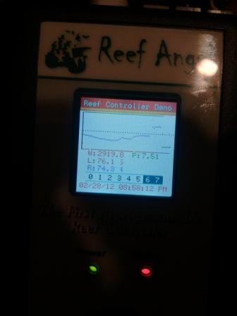

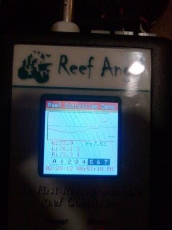

a similar problem with preloaded code. Some strange number on the screen in correspondence to temperature. Following the pics:
2012-02-28 20.57.14.jpg (20.71 KiB) Viewed 6156 times
2012-02-28 20.56.20.jpg (23.11 KiB) Viewed 6156 times
now I try with your last code.

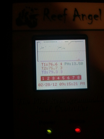

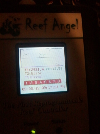

Unfortunately the problem remains:
2012-02-28 21.16.26.jpg (62.57 KiB) Viewed 6154 times
2012-02-28 21.14.22.jpg (45.43 KiB) Viewed 6154 times
