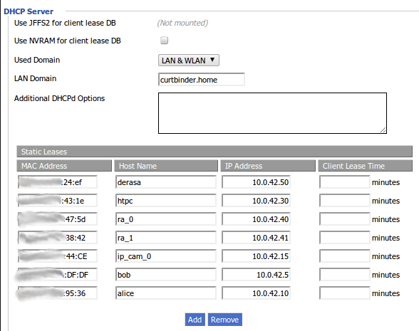

Re: wi-fi attachment set up
The lease time on the reserved address shouldn't really matter. Mine are all set for 1 day. What I did with mine is have mine serve up an ip address outside the normal DHCP range. My DHCP range is from 100-150. And here's what my static IP leases look like.
static lease
static lease
