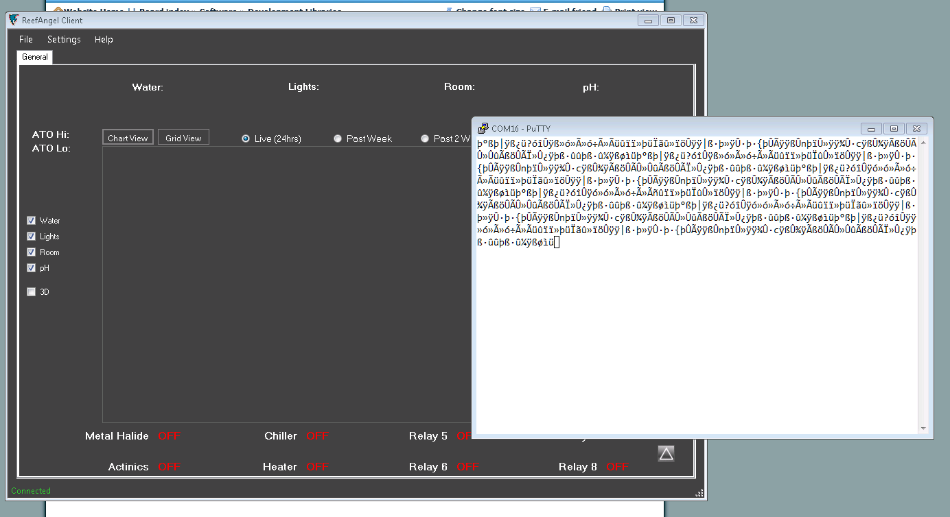

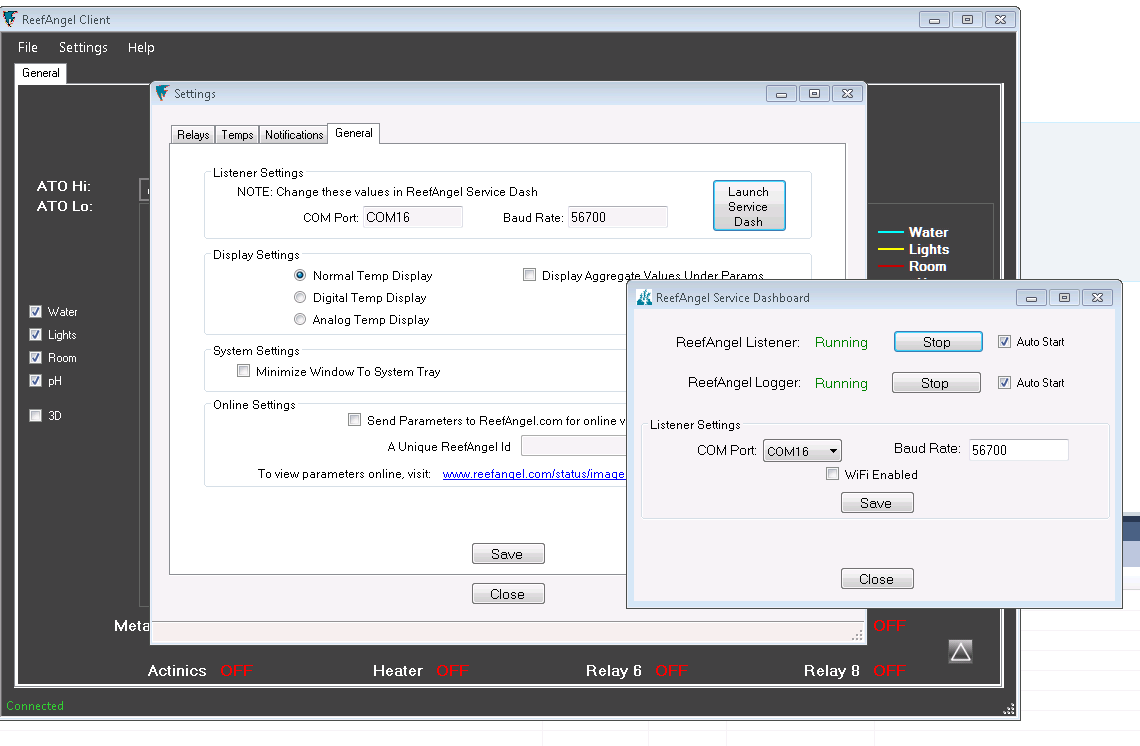

When you refer to configure serial, do you mean from ReefClient Service Dashboard Wifi NOT selected. I have Port 16 open at 56700, as well as "Listener" and "Logger" service running.. As you can see from thr pic I can open up Putty at anytime on Port 16 56700,8,N,1, and some data comes through every minute or so. Seems the listener is not "listening" otherwise the port would not be available for Putty?
Re: PC Logging
Posted: Wed Jul 20, 2011 4:10 pm
What do you have on "COM Port" under menu "Settings->Modify" and tab "General"?

If the Listener cannot open the serial port COM16 on 57600 right away, an internal timer will start for 30 seconds and then it will try again. It will repeat that process until it can lock the serial port and begin communicating.
In addition to that, when you make core changes to the listener settings, it will restart the service in order to actually apply them. It takes a bit to do that and you should probably see some red text at the bottom status bar of the Client saying "Unable to connect. Retrying in 2:00". After two minutes the Client will reconnect and begin displaying data.
I'm attaching a copy of the newest version of the "ReefAngel Serial Reader" application that comes bundled with the client suite installation. The older version that you have still relies on the controller to send out updates every 15 seconds which it no longer does. This new version uses the same Serial Port logic that the RA Listener uses to connect and send/receive data. So if this works for you, the Listener should also be doing its thing correctly.
To start with, just update your com port and baud rate and press the Open Serial Port button. It should say "Opened... Now Listening". If it does, just press the send button and see if you get a response similar to the one below. Make sure teraterm or putty is closed first and also stop the Listener Service from the dashboard.

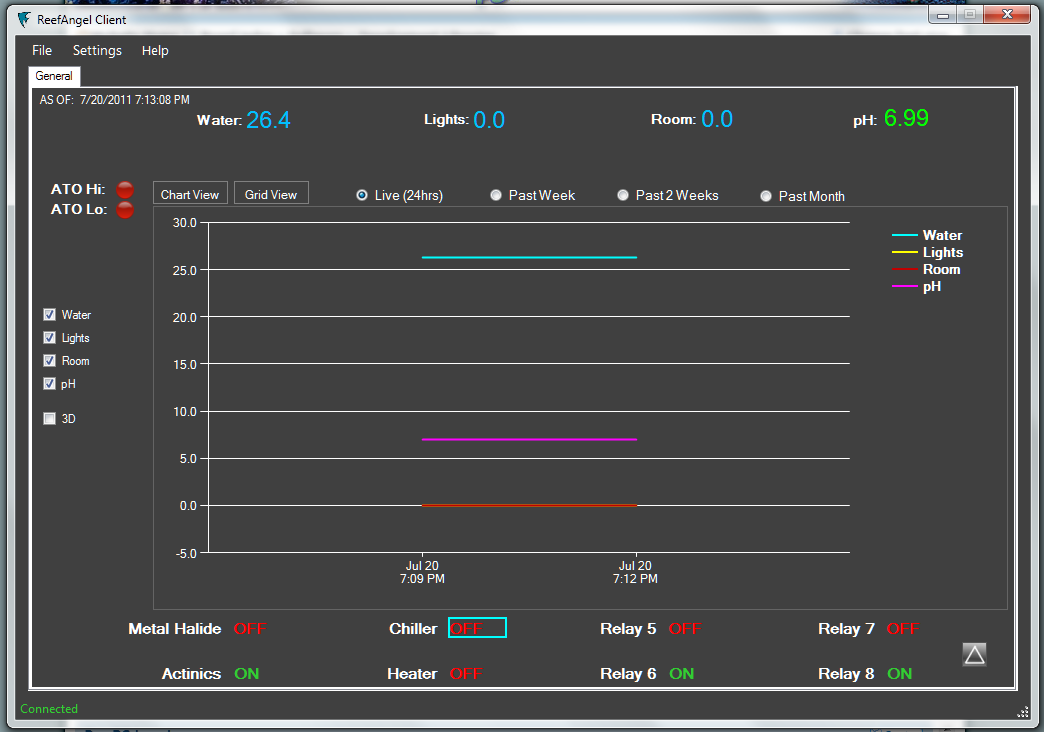

Success!!!.
Problem was twofold. I was getting the red text at the bottom, but while the listener was waiting to connect and turn green I would open Putty. This obviously locked the port for Reef Client so it could not receive anything from the listener. The garbage data on Putty was due to a cap on the MAX232 circuit not being fully seated. The SerialReader app worked like a charm, very helpful.
Picture speaks a thousand words. Thanks everyone, much appreciated.
