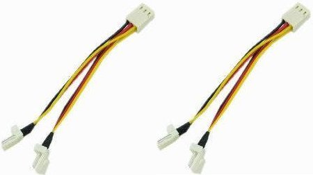

Re: Reef Angel Star Controller
Posted: Tue Nov 14, 2017 7:11 pm
No, you have to splice more probes in parallel to the existing ones or create your harness that has more connectors or get something like this from amazon or any other electronic store.
They are y-split cables for computer fans.
https://www.amazon.com/dp/B01DRE2UAI/re ... 0599452956
