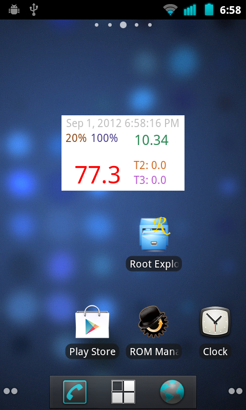

Now that v0.8 is released and it has the automatic updating, I've started working on some ideas for homescreen widgets. I've got a very rough screen shot of what it can look like. My idea is to have it mimic the home screen on the controller. A sample would be like the screen I did in my custom screen manual. Another one would be the default screen on the controller.
Here's all I've got so far....it only looks good in the portrait mode.
widget preview
widget preview
More thought and work needs to be put into it, but I wanted to share some ideas and possibly get some feedback too.

I know you can do it!!!! Simply amazing.
Would be cool if you can make it a live wallpaper?????
Adam
58 Gal

That looks great keep up the good work

Outstanding work as usual!
Can't wait to see that Widget :)

Really excited for a widget, looks like it's coming along well. Minor comment would be the ability to customize the background/text color and transparency. Also, thought it would be pretty cool to have the RA banners available as a widget option as well for tablets and some of the larger screen phones.
