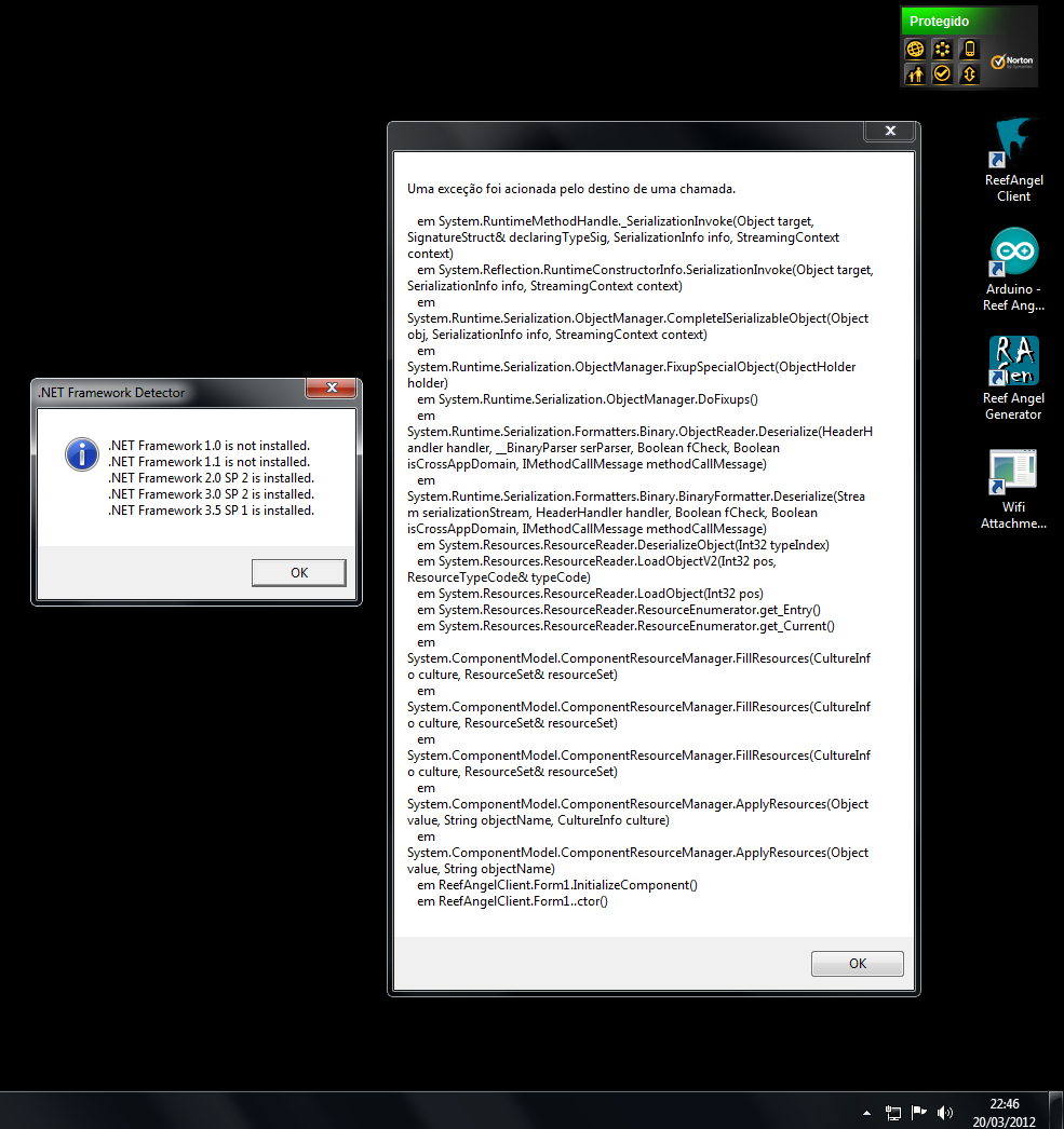

Client Suite 2.0 - 2.1 - 2.2 doesn't run!
I have all .net packages, but my client didn't run...
I have the .net 4.0 Client and complete installed too...
This is a known issue?
Regards
JC
Regards
JC
- CLIENT DON'T RUN.png (140.2 KiB) Viewed 9914 times

Junior, have you tried this yet? http://forum.reefangel.com/viewtopic.php?p=2599#p2599
- Posts: 17
- Joined: Mon Mar 26, 2012 5:32 am
Re: Client Suite 2.2
all fixed. i forgot to run the Cmd.exe as Admin.
thanks
