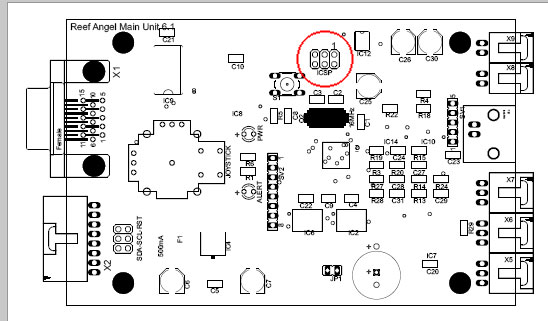

It does not matter Official IDE or RA installer IDE. They are about the same with just slight differences on some files, but I think your problem lies on the programmer itself.
Make sure RA is on when you want to program and also watch for the orientation of pin 1, which I forgot to add in the silk screen of the board.
Please see attachment.

Re: Bootloader upgrade (optiboot)
The silk screen for pin 1 would have been useful, but I managed to figure it out.
I also don't use arduino gui to upload my bootloader. I use the following command:
You will have to check the -c option for parallel programmer. Mine uses the ubstiny to upload. It took me a few tries to get things figured out on how it works but once I did, it has worked great for me.
avrdude -c usbtiny -p m328p -U flash:w:BOOTLOADER.hexcurt

You need to use Tools->Program, which calls atmega328_isp
program: atmega328_isp
ISPTOOL = usbtiny
ISPTOOL = dapa
- Posts: 2865
- Joined: Fri Mar 18, 2011 6:20 pm
- Location: Illinois
- Contact:
when I used avrdude, I had to use this for the -p command:
I tried the atmega328p and it gave me errors.
-p m328p
lukeluke
- Posts: 88
- Joined: Mon Apr 04, 2011 4:12 am
- Location: Rome, Italy
the option -P i think that on linux is not utilized:
i receive the same error on windows...
is possible that the chip is broken ?
can the DIY interface not work right ?
i see this http://cgi.ebay.it/ws/eBayISAPI.dll?Vie ... K:MEWAX:IT what do you think ?
[luke@PC_005299 optiboot_ReefAngel_v4.0]$ avrdude -c dapa -p m328p -e -u -U lock:w:0x3f:m -U efuse:w:0x05:m -U hfuse:w:0xDE:m -U lfuse:w:0xFF:m
avrdude: AVR device not responding
avrdude: initialization failed, rc=-1
Double check connections and try again, or use -F to override
this check.
avrdude done. Thank you.is possible that the chip is broken ?
- Posts: 2865
- Contact:
i would also get that error on windows if the programmer wasnt recognized properly. I had to unplug it and plug it back in to get it to work. I also have to have my controller powered on for it to work too. I would also make sure that your parallel pprt is enabled and working too.
It could be that your programmer is not wired up properly.
Chrome has made one and he had sucess in burning his bootloader.
The link you sent is the kind of programmer you are looking for, except that one does not support ATMega328P. If the chip was broken, your whole RA would be broken, so I doubt it's the chip.
I use a USBTiny programmer. You can buy it at adafruit or sparkfun:
http://www.adafruit.com/products/46&zen ... 469c4ccacc
http://www.sparkfun.com/products/9825
- Posts: 2865
- Contact:
I have the same programmer but it does not work with linux. So i have to use windows to program my bootloader.rimai wrote:It could be that your programmer is not wired up properly.
lukeluke
- Posts: 88
oh yeah!!!!!!
I retry on linux and it's works !!!!!
