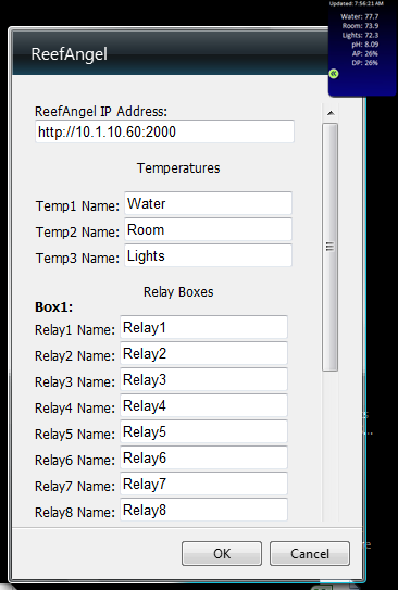

58 Gal
Re: New Windows Gadget
Weird.
Are you using the version posted on this page?
Here is how mine looks.

I was having the same issues at first. Make sure you don't have the trailing slash at the end of your URL: http://ipaddress:2000
It took a a few seconds, maybe a minute, after dropping the trailing slash for it to start registering.
