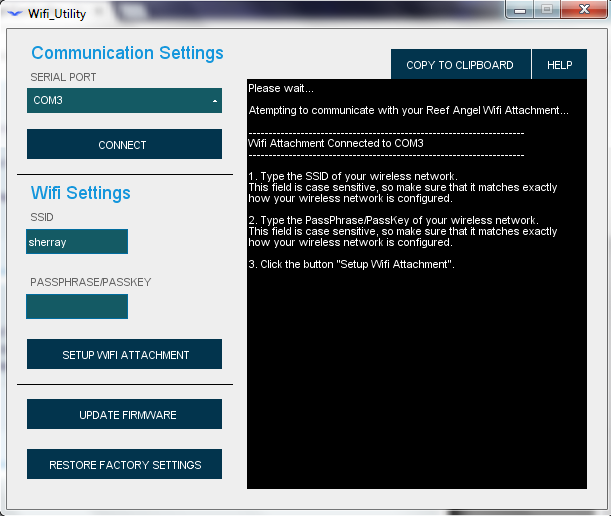

Hi there,
With the 2nd type of connection, will it work if there is no passphrase? I am not sure why it would but it does nothing once I click "setup wifi attachment" just leaves black. I have talked to my master (father) and it is all to hard to put one on to try :roll:
I am getting to this point and then nothing. :?:
wifi utility 1.png (63.35 KiB) Viewed 52183 times
Cheers
Cody
Re: How to setup your wifi attachment
I don't think it would work with no password

yeah typed i a random bunch of letters and it did something but obviously didn't work. here comes the next 6 months battling to get one lol
Cheers
Cody
cody.sheridan-2008
Posts: 31
Joined: Tue Feb 05, 2013 9:39 pm
Post by cody.sheridan-2008 »
rimai wrote:I don't think it would work with no password
Hey roberto,
The wifi attachment will work if you have no password you just need to put a space in the box.
Cheers
Cody
