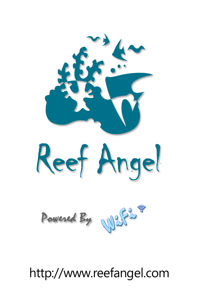

If anyone wants to create any new loading screens or interface feel free, I am terrible with graphics. :)
Here is what it currently looks like:

Re: Did someone say iPhone app?
Here it is.
I hope this helps.

icon looks great, thanks.
We may have to scrap the loading screen since Apple is not too fond of them. But we will see. Got anything for that? Size should be 640x960. My current one looks a little grainy on the iPhone 4.
How about this one?
