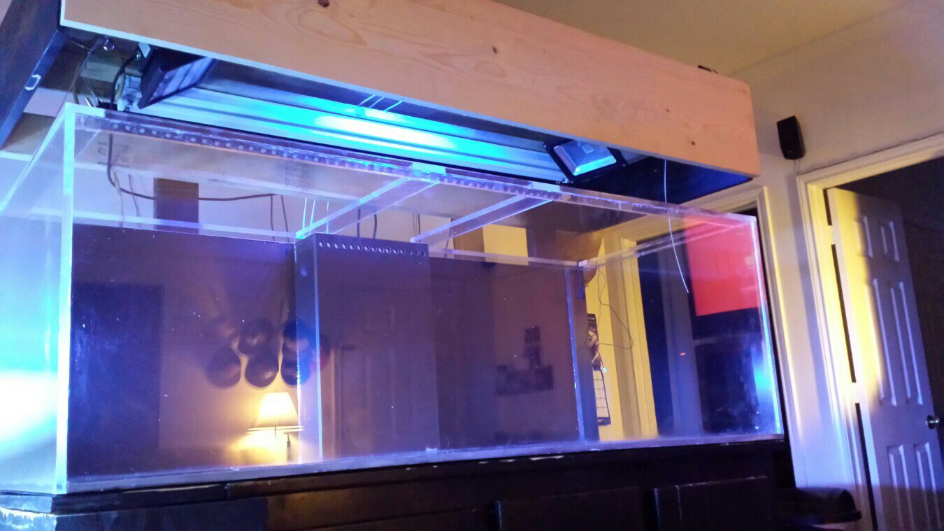

[attachment=-1]uploadfromtaptalk1391873107739.jpg[/attachment]
