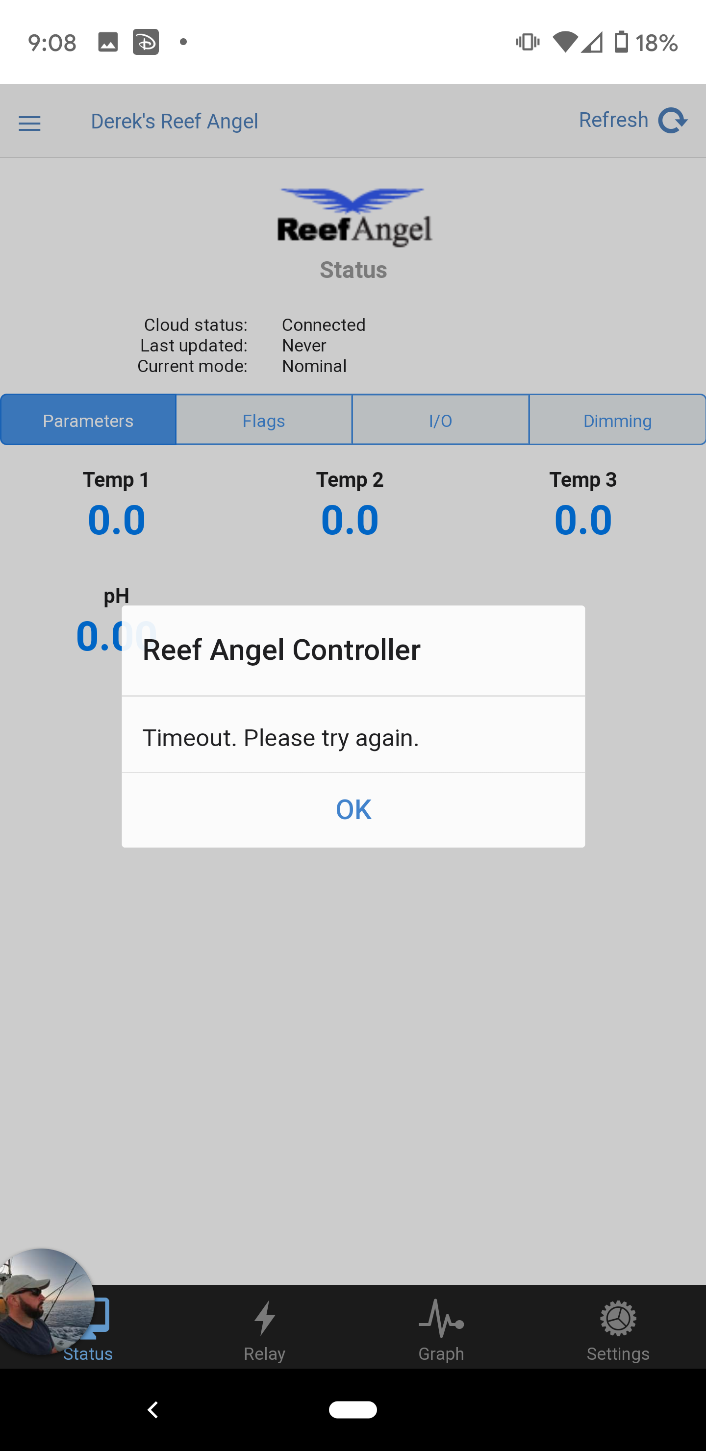

Re: Uapp Graph shows no Data to display always.

hows this? RA Init
SPI Init
LCD Init
Network Init
Touch Init
SD Found: 1
SD Init
192.168.1.19
MQTT Connecting...
MQTT failed
MQTT Connecting...
MQTT succeeded
Portal Call
Data Sent
HTTP/1.1 200 OK
Cache-Control: private
Content-Type: text/html; charset=utf-8
Server: Microsoft-IIS/8.5
X-AspNet-Version: 4.0.30319
X-Powered-By: ASP.NET
Date: Sat, 31 Oct 2020 01:16:56 GMT
Connection: close
Content-Length: 4
DoneDisconnected
Connecting...
Connected
HTTP/1.1 200 OK
Content-Type: text/html; charset=UTF-8
X-Powered-By: PHP/5.6.24
Date: Sat, 31 Oct 2020 01:16:57 GMT
Connection: close
Content-Length: 0
Data: 0
Header: 0
Disconnected
i need to push my code back asap as tank is down....

The code I sent had the encrypted password for the test username we were using.
If you are using your username, you have to use the correct encrypted password on field RA_STRING1
Posted: Fri Oct 30, 2020 7:36 pm
The string for your password is this RA_STRING1=U2FsdGVkX18SRGs3W6Nho4tbkPQm9kNx1zw1++/r4LSB5npUkT/wWfcMeCtcWzAq

It's not the labels

Cloud seems to keep cleaning my controller frrom UApp now. Is that likely intentional?
Posted: Fri Oct 30, 2020 9:05 pm
by SouthernReefer
rimai wrote:Damn. Let's resume tomorrow. I have to put my daughter to bed.
Ok I'll push the original code so at least things are there for now until tomorrow
Posted: Sat Oct 31, 2020 2:19 pm
by SouthernReefer
Soooo next steps? Pushed my original code last night and cloud is broken...
