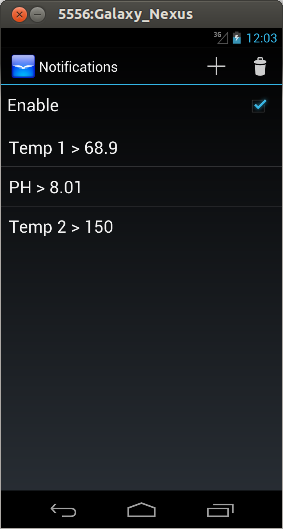

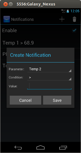

Adding to my last post, I've got the Notifications working. I still have to do some testing before I release a new version, but wanted to give you a teaser (or 2)....
As you can see, there's the list of notifications and you can easily Add, Update or Delete them. I've only shown the Add dialog. If you "click" on the notification in the list, it brings up the same window that allows you to Update or Delete the notification. You can also easily delete All notifications with the trash can icon in the actionbar.
Lastly, the Enabled checkbox at the top of the window enables the notifications. Notifications for the app must be enabled (errors and notifications). I've added the checkbox here so you can quickly and easily enable / disable without having to goto the settings page. Like I said, if you disable the Notifications, then you disable ALL notifications (errors and parameters). If you don't want any parameter notifications, just simply delete all of your rules and you will be set.
