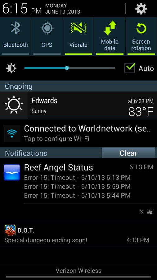

This is what I'm seeing

that is saying that it is timing out trying to connect to the controller. it's exceeding the 15 second timeout period waiting for a response from the controller.
