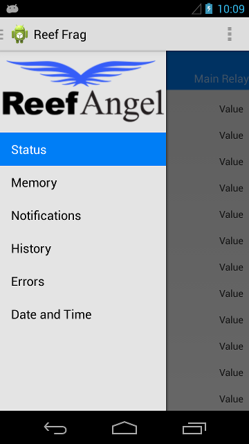

I'm working with a test app to get the layout and colors working properly. I decided to have a little fun and add in some Reef Angel branding. What do you think of this??
android drawer
android drawer
I can switch the background to be all white, but I'm using the default Holo Light background color which is a light gray. The same light blue color for the selection will be in the swipe headers (as you can barely see behind the navigation drawer). I still have to make all the changes in the main app, but I figured I would give people a teaser for the "new look".
Feedback is always welcome. :geek:
