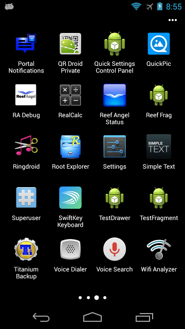

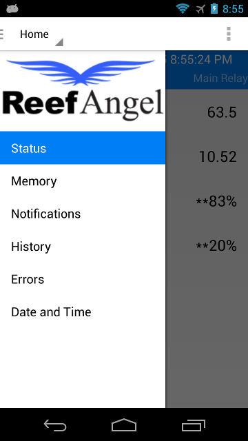

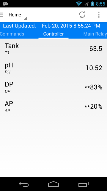

Here's some screenshots of the "new" icon and look. As you can see, I removed the actionbar icon and it's now blank next to the spinner. The Reef Angel logo is visible in the navigation drawer, which compliments the app along with its colors. Then, there's the nice white RA logo instead of the blue one, which is displayed in a launcher.
So this would be getting rid of blue icon to differentiate it from the universal app. Thoughts?
Navigation Drawer
Navigation Drawer
Home Screen
Home Screen
Launcher with icon
Launcher with icon

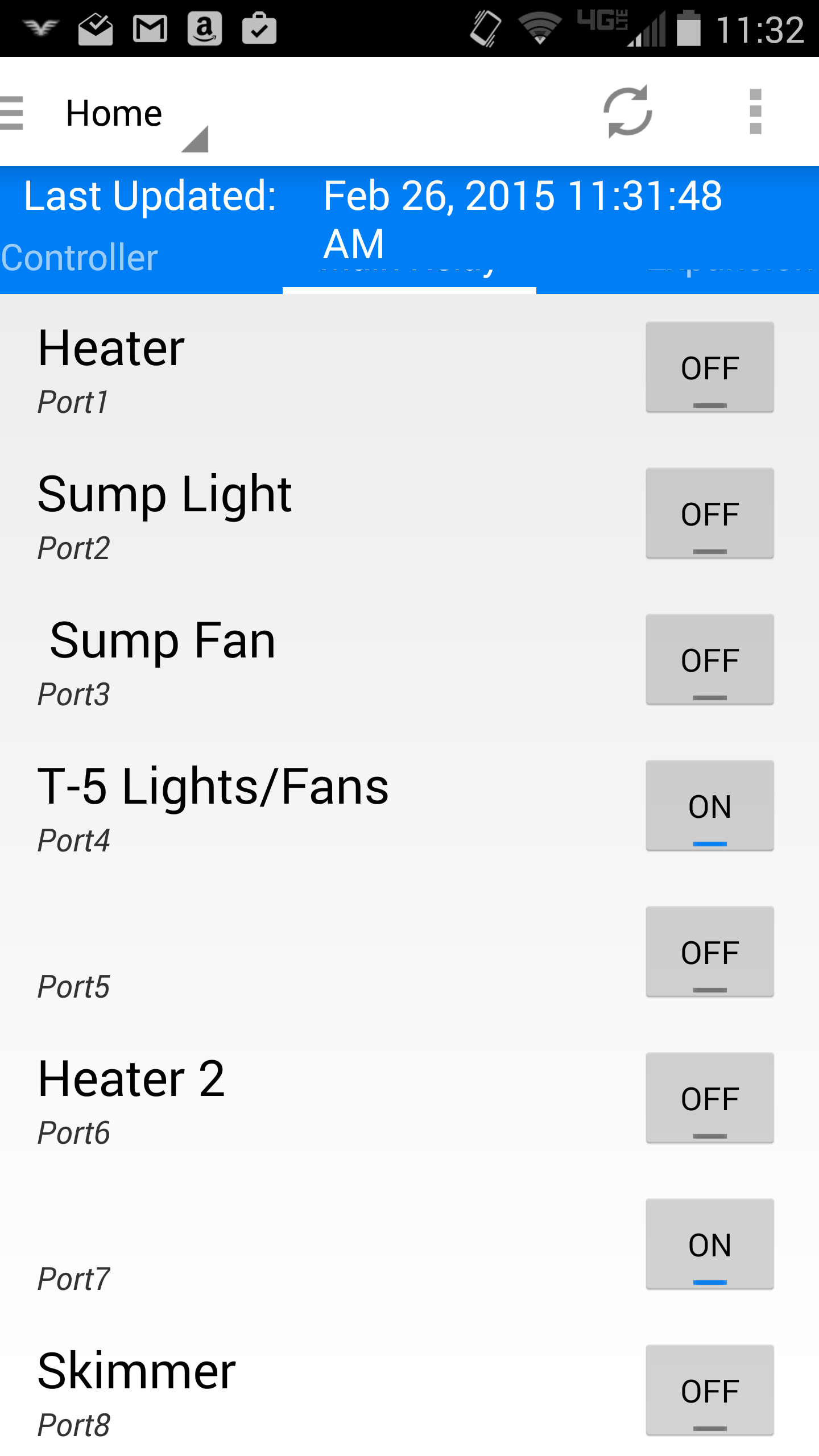

The screen Label gets covered up be date and notifications
yeah. i knew it did that with the errors but had not seen it on the normal dates. I will look into either making the text smaller or adding extra spacing for that text box or even removing the text "last updated" altogether. any preference?

What about moving the last update block to the slide menu to the aide
pandimus wrote:What about moving the last update block to the slide menu to the aide
Like right below the ReefAngel logo?
Hmmm...I'm not sure how easily I can update the values in the navigation drawer. Also, I would be inclined to think that having the Last Updated time always visible on the screen is an important thing to know.

Just trying to think of how it won't Interfere.. 24 hour time.. No am/pm should keep it small enough
pandimus
Posts: 213
Post by pandimus »
Actually it's fine now.. Seems it just a matter of that one digit..
