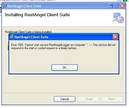

I'm getting an error after I select the USB com port. This is a fresh install on Windows XP Pro. Help?
- install error.JPG (33.38 KiB) Viewed 15805 times

The Logger Service uses the SQL Server Compact Libraries and a small .sdf file to store your historical data and user settings. The SQL Libraries are included in the installation but rely heavily on the .Net 3.5 SP1 framework. If it's a fresh install of XP, odds are you do not have that framework installed.
Have a look here:
http://www.microsoft.com/download/en/details.aspx?id=22
The Client portion of the ReefAngel Suite references the .NET 4.0 Client profile but either the .net 4.0 client or full version of the framework should be cool:
4.0 Full:
http://www.microsoft.com/download/en/de ... x?id=17851
4.0 Client Profile
http://www.microsoft.com/download/en/de ... x?id=17113
Try installing the necessary frameworks and reinstall the Suite. Hopefully that should do the trick.
-Dave

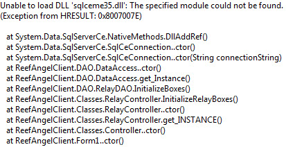

Getting the attached error when trying to start up the client suite. Running Windows 7 64bit.
Any ideas?

.NET 3.5 SP1 is the important one to address the error you attached. Is that installed as well?alexwbush wrote:I reinstalled the 4.0 Full version. Same error.
- framework.jpg (183.95 KiB) Viewed 15791 times

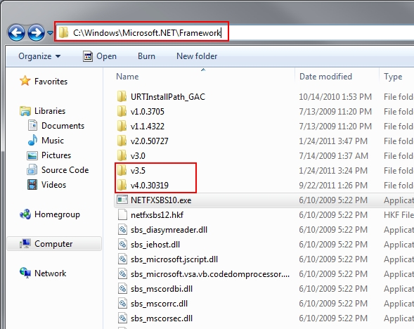

Looks like I have the proper .NET prereqs installed.
- framework.jpg (61.24 KiB) Viewed 17108 times
