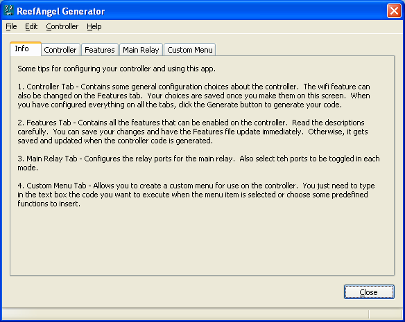

When RAGen starts up, you will be presented with this screen:
Info Tab
Info Tab
If you have never used RAGen before, make sure you READ the screen.

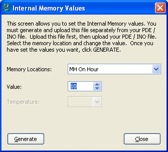

Goto the Controller menu and select Internal Memory. You will be presented with this window:
Internal Memory Window
Make sure you read the note at the top of the window. Once this window is open, you should go through and review the memory settings. The default values are preloaded. Select the memory location from the drop down list and look at the value it has stored. If you do not like a value or want to change it, either type in the new value or use the up/down buttons to change it. Once the value is changed, it is saved. After you have looked through all the memory locations, you will want to press the Generate button to generate the Internal Memory file to be loaded on your controller. After you generate the file, you can launch Arduino to upload your memory file to the controller.
If you launched arduino, it will open with the memory file. You can upload it to your controller now. When completed, your controller will say "Internal Memory Set, Now load your RA code file". Now back to RAGen.
Once your memory values are set AND you have generated the memory file, you can close the Internal Memory window.

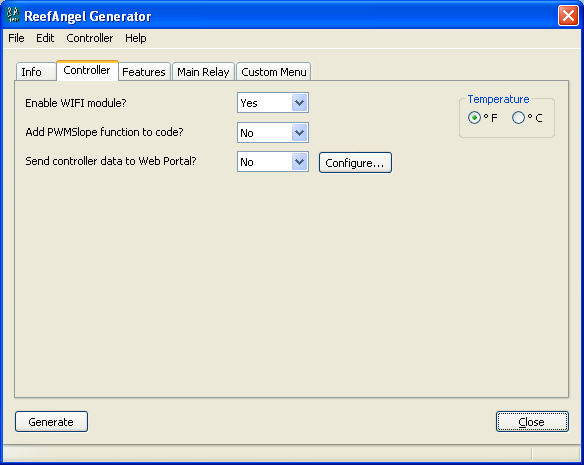

The next tab is the Controller tab. On this screen, there are only a few options / choices.
Controller Tab
Controller Tab
You can:
  • Set the controller temperature to F or C (F is default)
  • Enable WIFI module (enabled is default). You can also enable the WIFI module on the Features tab
  • Add PWMSlope function to code (No default). Enabling this will add the pwm slope to your code for the Actinic and Daylight channels only (pwm channels on the controller). The PWM Slope function uses the Standard Lights ON/OFF schedule and the start and end percentages and duration from internal memory. PWM Slope will not be discussed here, there is a separate thread on it (http://forum.reefangel.com/viewtopic.ph ... lope#p5679).

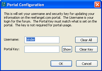

  • Send controller data to Web Portal (No default). This will send your controller data to the portal for viewing on the portal. If you click the Configure button, you will get the Portal window where you can add your username (login username for the forum) and an optional security key. The security key entered is the same one you set on the Portal.
    Portal Window
    Portal Window
  • Last, the Generate and Launch (only after Generate) buttons are here. Generate saves all the features and creates the features file and then generates the controller code.

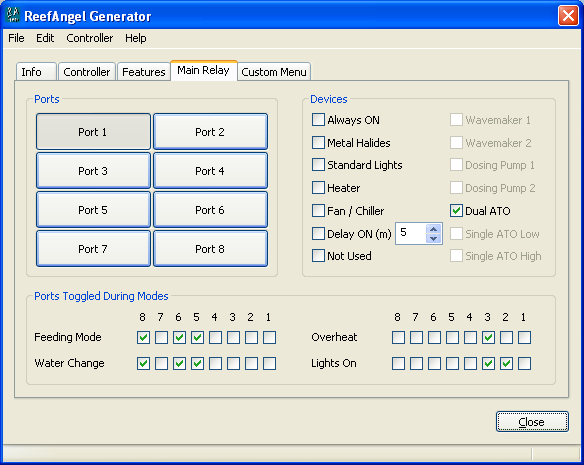

The Main Relay tab is next. This tab was initially called PDE. Then it was renamed to PDE / INO.
Main Relay Tab
Main Relay Tab
You have a list of the Ports / Relays on the left. Select the Port you wish to modify and then select the device you would like to assign it on the right. You can only use the devices in the right column 1 time each. If they are not available, they are greyed out. You are only able to use a Wavemaker or a Dosing Pump. You are not able to use them both at the same time. You can, however, use a Wavemaker 1 and a Dosing Pump 2. You just cannot use both Wavemaker 1 and Dosing Pump 1 at the same time. This may change in the future but currently that's all RAGen allows.
At the bottom of the screen, you can select what ports are toggled in the corresponding modes. If you want a port turned OFF/ON when entering/leaving a mode, place a Check in the appropriate box.

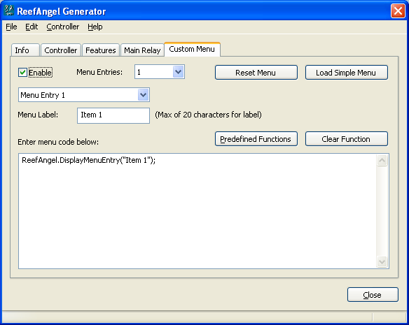

The last tab is the brand new one that is welcomed. This tab is the Custom Menu tab.
Custom Menu Tab
Custom Menu Tab
This tab allows you to enable the custom menu (also in the Features tab). This handles most of the difficult stuff. There is some explanation for the screen.
  • Menu Entries - This is where you set how many entries your menu has. As you change this value, the list box that says "Menu Entry 1" will change based on the entries selected.
  • Reset Menu - This will reset the menu to the default / generic menu. This will erase ALL OF YOUR CHANGES. Use this with caution. There is also a warning that pops up if you press this button.
  • Load Simple Menu - This does exactly what it says. It will erase everything in your menu and load the simple menu. There is a prompt before it proceeds as well. You can load the simple menu, then change / update it if you like.
  • Menu Entry List - Use this drop down list to change / select the menu Entry to update. As you change the selection, the labels and menu code will change.
  • Menu Label - Enter the label you would like to use for the menu entry. This is the label you see on the controller screen to select.
  • Menu Code Box - This text box is the "guts" of the menu function. Place your code you would like executed when the menu is chosen.
  • Predefined Functions button - This button displays a list of common functions that can be used. It does not contain all of the functions, just the majority of them that will be used. Some functions require additional changes to work properly, which should be obvious as to what needs changed. If not, simply ask for help on the forum.
  • Clear Function button - This button clears the code for the current function. This cannot be undone, so use with caution.
Your menu is saved as you are working on it. You do not have to do anything to save it. Once you have finished editing your menu, you can click the Generate button on the Controller tab to have the entire controller code generated (menu and all).

I have to say though, I'm not a fan of the new Internal Memory form at all. The old way in my opinion had it right. Now it seems very cumbersome to modify the memory values, especially if you're changing more than 1. A lot of searching/scrolling to find the location you want. This will be especially painful for a new user setting up a new controller. You will have to go individually one by one through each item in the dropdown and set a value. There's no more visual feedback as to how their controller is going to function in the big picture. All you see now is how one individual part of the controller will function. i.e. what minute the MH Lights are going to turn off. I really liked the 10,000' birds eye overview from the old form showing you everything.
Once a user does go through and set every value individually there's no way to verify, double check, or be sure that everything is set the way you want before you save. You'll probably end up going through one-by-one again to make sure and probably write down the values in notepad or a piece of paper to simulate that 10,000' overview. Exactly what the old form did just by its very nature :!: .
Once I upload my sketch and decide I need to change something in internal memory and I open RAGen again, did my Internal Memory settings get auto-loaded for me? I assume it did and I assume the values are correct but how will I know for sure? Do I have to go through each and every memory location in the combobox again to make sure? Only after verifying one by one, then can I make the change I want. If I forget what time I set my STD Lights to come on and off - The old way I just open RAGen and with 1 click on the "Internal Memory" button I can see exactly when they come on and off. Plus when the MH come on and off, plus when the heater comes on and off.. All for free.. The new way it takes like 6 or 7 clicks total to see when those STD lights come on and off. Plus some more to change them. Changing pH or PWM % values the old way took 0 additional clicks, and that goes for every memory location value available.
In my opinion, this is one case where the similarities between the Android app and RAGen should be miles apart. With Android, you don't have many options when you want to present a large list of items that can be modified. With a WinForm, however you have many options and in both cases, Android and WinForm, you want to provide users with the easiest most intuitive way possible to interact with your application for that platform.
The old way was: well thought out, organized, structured and intuitive. It gave me instant feedback about how my controller was going to function on a day to day basis:
The new way feels: painful, klunky and cumbersome. Like it's sucking the soul out of me and terrorizing my children - and I don't even have kids! :o But that's the way it makes me feel!!
I cry a little inside when I see what has happened to my poor internal memory form. :cry: I think you had nailed it the first time around. I vote to resurrect our dearly beloved from the ashes!!
