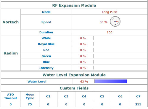

Look at my portal custom var section:
I have the ATO timeout and moon cycle %.

Just wanted to be sure I was getting it. when I looked at your custom variables section snapshot on the previous page you have the ATO box labeled so I wasn't sure. I just need to be sure what I am going to code in is going to work.

something is still not quite right...
forced another ato timeout. Red LED on controller is on. Portal says C0=0 and skimmer is still on. Portal still shows relay port 4 for my skimmer to be "auto" android app says on but not masked (no green dot).
here is my code. I have to be missing something... wait it might be my bogus sump empty float switch
iochannel0flag = ReefAngel.IO.GetChannel( 0 );
is probably setting the LED the switch has been stuck in the active position for weeks even though the switch is fully submerged with the wires out the top (IE it should NOT be active) Gonna rem it out and try again. I had it rem'd out in my previous running config before today's experiments.
Not thinking the IO channel was the culprit. I used the clear ato command from the android app and the LED turned off. why is my c0 variable not updating?
I may be on to it... I found this line where the RA+ manipulates the buzzer etc.
atoflag = InternalMemory.read( ATO_Exceed_Flag );
and the code I was running was
ReefAngel.CustomVar[0]=InternalMemory.read(ATO_Single_Exceed_Flag);
since I am using dual ATO not single maybe I am looking at the wrong flag
it should probably be...
ReefAngel.CustomVar[0]=InternalMemory.read(ATO_Exceed_Flag);
Also this line of code in my if statement
ReefAngel.Relay.RelayMaskOff=Port4Bit;
is still masking Off all my relays EXCEPT 4 which is staying on auto. I guess I need to try to figure out how these functions work. Obviously not how I think they work. lol ;)
Nick
