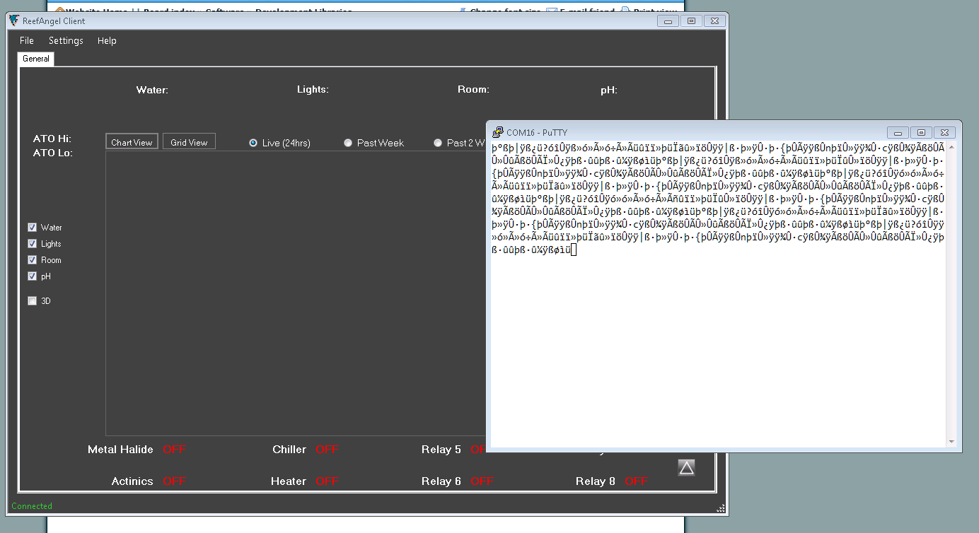

Well, gettting there, problem was a miswired cap on the max232. With the preloaded code using the "Dump to PC", "dump Parameters to PC" I can transmit a bunch of garbage characters to the pc using Putty with 57600, 8,1,N,. Seems to follow a pattern so think the baud rate may be mismatched.
Using the development libraries and the RAgen I can not get anything on Putty or with ReefClient 2.1. Could see not getting anything with Putty because it needs to pull from the controller, although nothing on Putty when I click keys on the computer.
Getting close anyways.

Thanks, tried 115200, but still garbage, could be the wiring etc. Is the Reef Client 56700?. I don't think the com port is being opened up by the Reef Client as I can still open the same port with Putty. The reef client should have locked the port??. I do receive some garbage characters on Putty about every minute or so, which doesn't make sense unless the controller is sending it out?

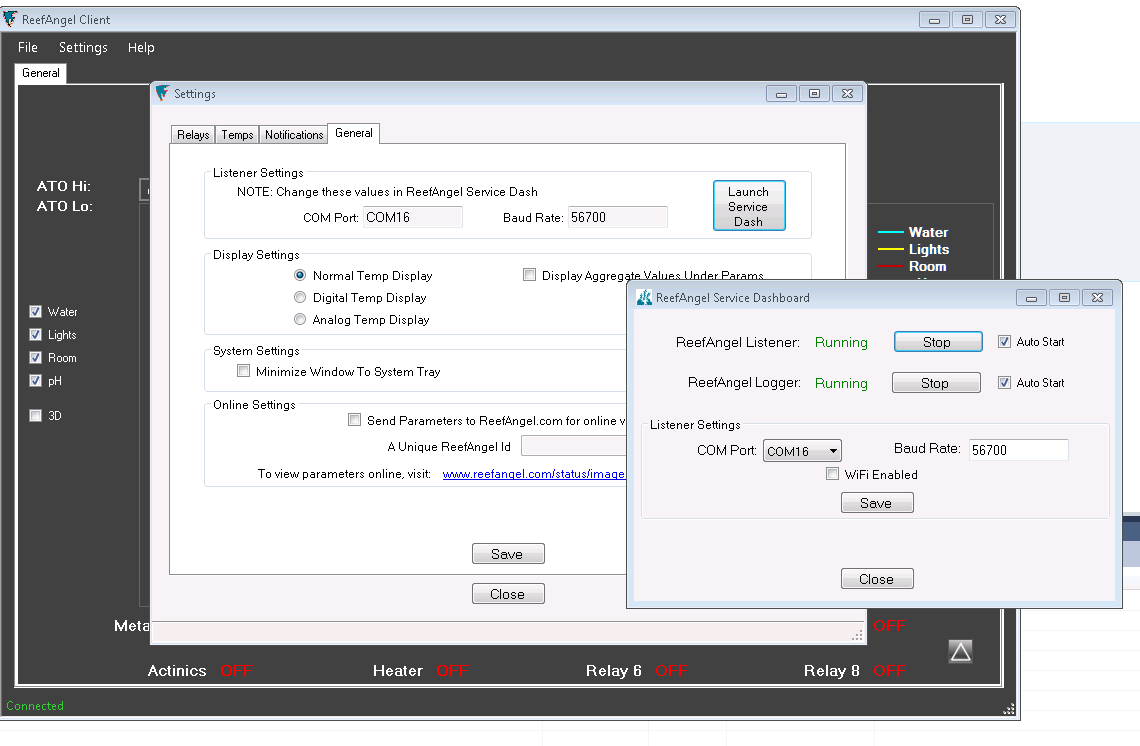

When you refer to configure serial, do you mean from ReefClient Service Dashboard Wifi NOT selected. I have Port 16 open at 56700, as well as "Listener" and "Logger" service running.. As you can see from thr pic I can open up Putty at anytime on Port 16 56700,8,N,1, and some data comes through every minute or so. Seems the listener is not "listening" otherwise the port would not be available for Putty?
Re: PC Logging
Posted: Wed Jul 20, 2011 4:10 pm
What do you have on "COM Port" under menu "Settings->Modify" and tab "General"?
Re: PC Logging
Posted: Wed Jul 20, 2011 4:35 pm
by Bryan
Com 16...

Hahah.. I know now.
It's 57600 not 56700 :)
Re: PC Logging
Posted: Wed Jul 20, 2011 4:55 pm
by Bryan
No go, I have changed around with it so many times I must have typed it in wrong on the last go, changed to 57600, but still not working. Still can't explain why putty will open up when reef Client is open, the port should be locked. Strange. Wonder if it is my max232 setup is part of the problem. Think I best try a pic USART project to see if it can communicate correctly with putty at 57600. Perhaps the data is garbled and the controller doesn't recognize the sequence.

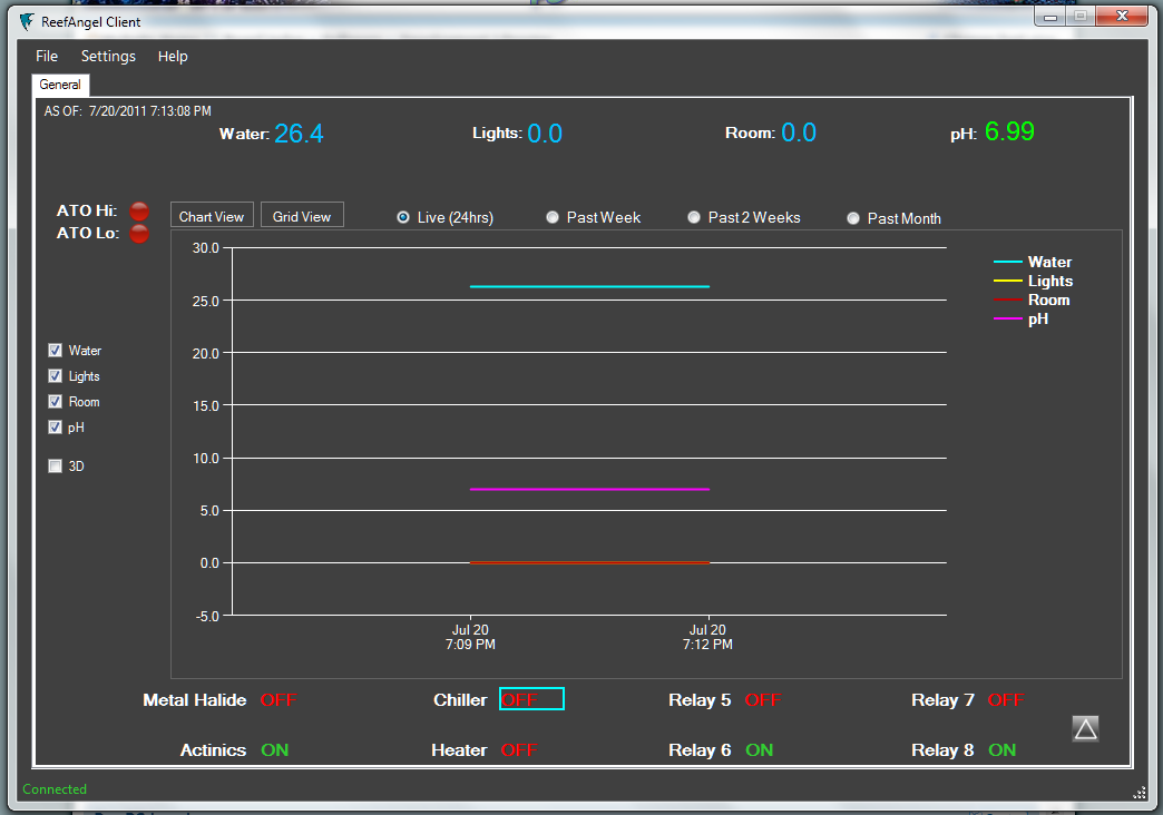

Success!!!.
Problem was twofold. I was getting the red text at the bottom, but while the listener was waiting to connect and turn green I would open Putty. This obviously locked the port for Reef Client so it could not receive anything from the listener. The garbage data on Putty was due to a cap on the MAX232 circuit not being fully seated. The SerialReader app worked like a charm, very helpful.
Picture speaks a thousand words. Thanks everyone, much appreciated.
