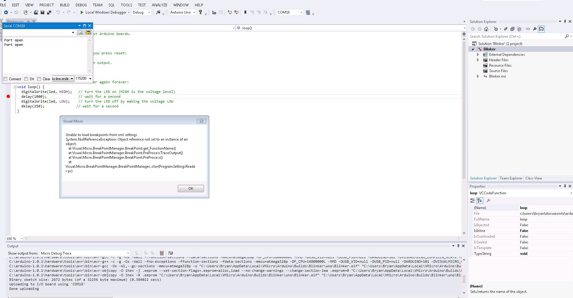

In order to enable debugging you must sign up as a Beta Tester, there is likely going to be a cost for the plugin after the beta stage I would assume. Hope it is reasonable.

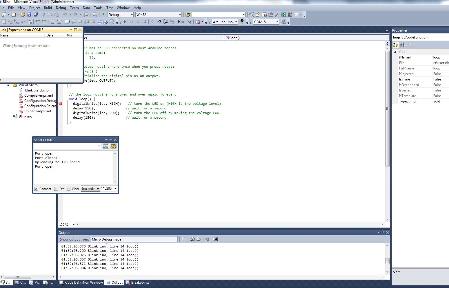

As you can see here is the simple Arduino Blink example being debugged, it compiled fully and uploaded to my UNO using Visual Studio and the plugin.

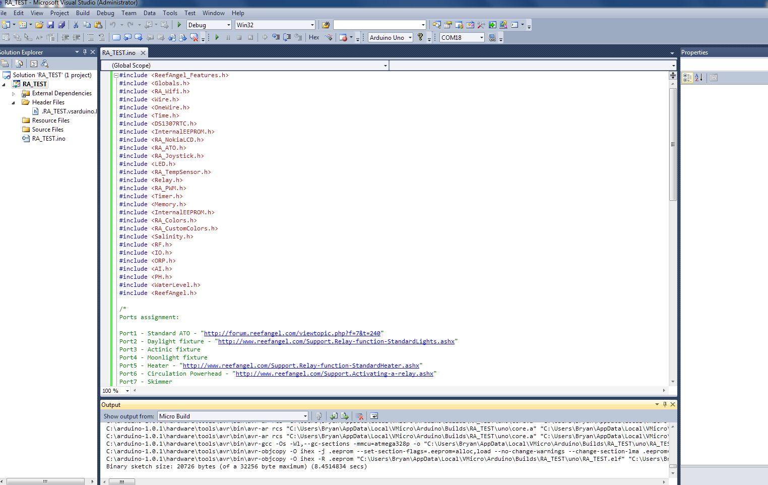

As well the Reef Angel ExampleCode 1 sketch easily compiled. Unfortunately I don't USB to TTL cable so could not confirm that it would upload correctly to the ReefANgel. I can not see why it would not. I can upload the *.hex using my AVR dragon and ISP and it is fine, but can not debug with the Dragon setup.
