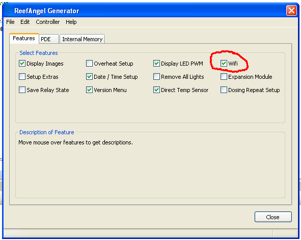

Since you say that if Web Banner is unchecked you can get the code to compile that is a good start. When you check Web Banner on the PDE page, you must also check WIFI on the Features page. If you do not check WIFI, then those 2 functions you are getting errors about will not be available. Currently RAGen does not automatically select WIFI when you choose Web Banner, that is something you must manually select.
For those of you who like pictures: :D
When you select this:
You must also select this:
Doing this should fix the problem.
If this does not fix the problem, please attach your PDE file that is generating the errors AND attach your ReefAngel_Features.h file (from your libraries/ReefAngel_Features/ folder).
