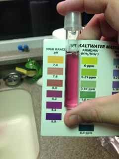

ph no bueno
Real ph matches where I was before probe went wonky.
