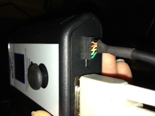

Can you take a photo of the usb-ttl cable connector? The one with several colors at the end?

Re: Error Uploading
here it is
sorry its a link the forum wont let me upload the picture
http://i241.photobucket.com/albums/ff19 ... ac25a0.jpg
Sebyte
Re: Error Uploading
It looks like you have it plugged into the wrong pins, although it is not that clear in the pic. The plug should be biased to the right not the left, i.e. the black lead should go to the right most pin.
Sebyte
Re: Error Uploading
Just taken a second look and you are connected correctly. I initially had problems by missing the end pin.
