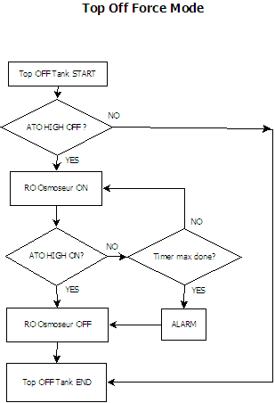

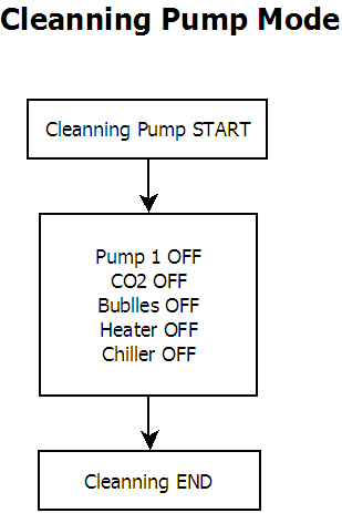

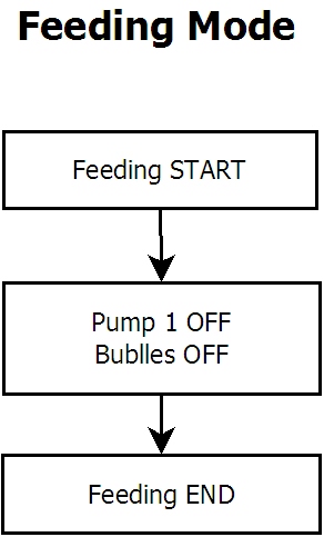

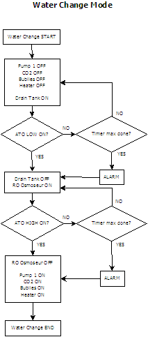

Hello everybody,
I need your help to do my pde for my new tank ;-)
[youtube]http://www.youtube.com/watch?v=MfXhgFvWprk[/youtube]
Here is what I need :
Standard running
• Light 1 ON : 7h00 am --> 8h30 pm
• Light 2 ON : 8h00 am --> 11h00 pm
• Moonlight ON slowly % : 10h55 pm --> 7h00 am
• Heater :
o ON When TEMP <= 29°C
o OFF When TEMP >= 29.5°C
• Chiller : ON When TEMP >= 31.5°C (Overheat)
• CO2 :
o ON When PH >= 6.5
o OFF When PH <= 6
o OFF between 11h00 pm and 7h00 am and IF PH >= 6.5
• Bubbles :
o ON When PH <= 5.8
o ON between 11h00 pm and 7h00 am and IF PH <= 5.8
• Pump 1 ON
• Water Change mode ON one time every day at 1h00 pm
Menus
• Feeding
• Water Change force
• Top Off Force
• Cleaning pump
• Vacuum Cleaning
• Standard Lights
• Moonlights
• Version
Relay Box
1: Light 1
2: Light 2
3: Bubbles
4: Heater
5: CO2
6: RO Osmoseur
7: Drain Tank Pump
8: Pump 1
Actinic LED driver output : Moonlights LED 12V DC
Daylight LED driver output : Chiller 12V DC
Vacuum Relay?
Wifi log YES and Banner YES
Client suite will be the next step ;-)
TOPOFF Force.png (7.87 KiB) Viewed 9802 times
Thanks for your help
Water Change.png (8.09 KiB) Viewed 9801 times
