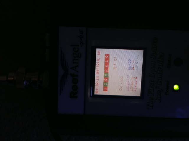

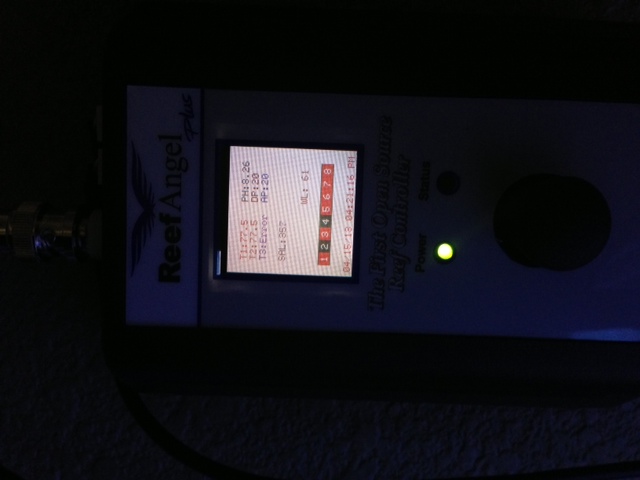

I haven't loaded the RF expansion back into the system and I'm still seeing the system reset occasionally. It flashes the sequence 1 time and reset system. I don't have any thing near the relay box except for the expansion modules.
I'm including a couple pictures the before is when I walked into the house and looked at the LCD and the backlight was on and they screen was messed up. The after is what the screen normally looks like after I removed and replaced power.
Re: RA hanging or heater relay clicking
Are you able to toggle the ports when the screen is like that?
Like, if you push the joystick twice, does it enter feeding mode?
