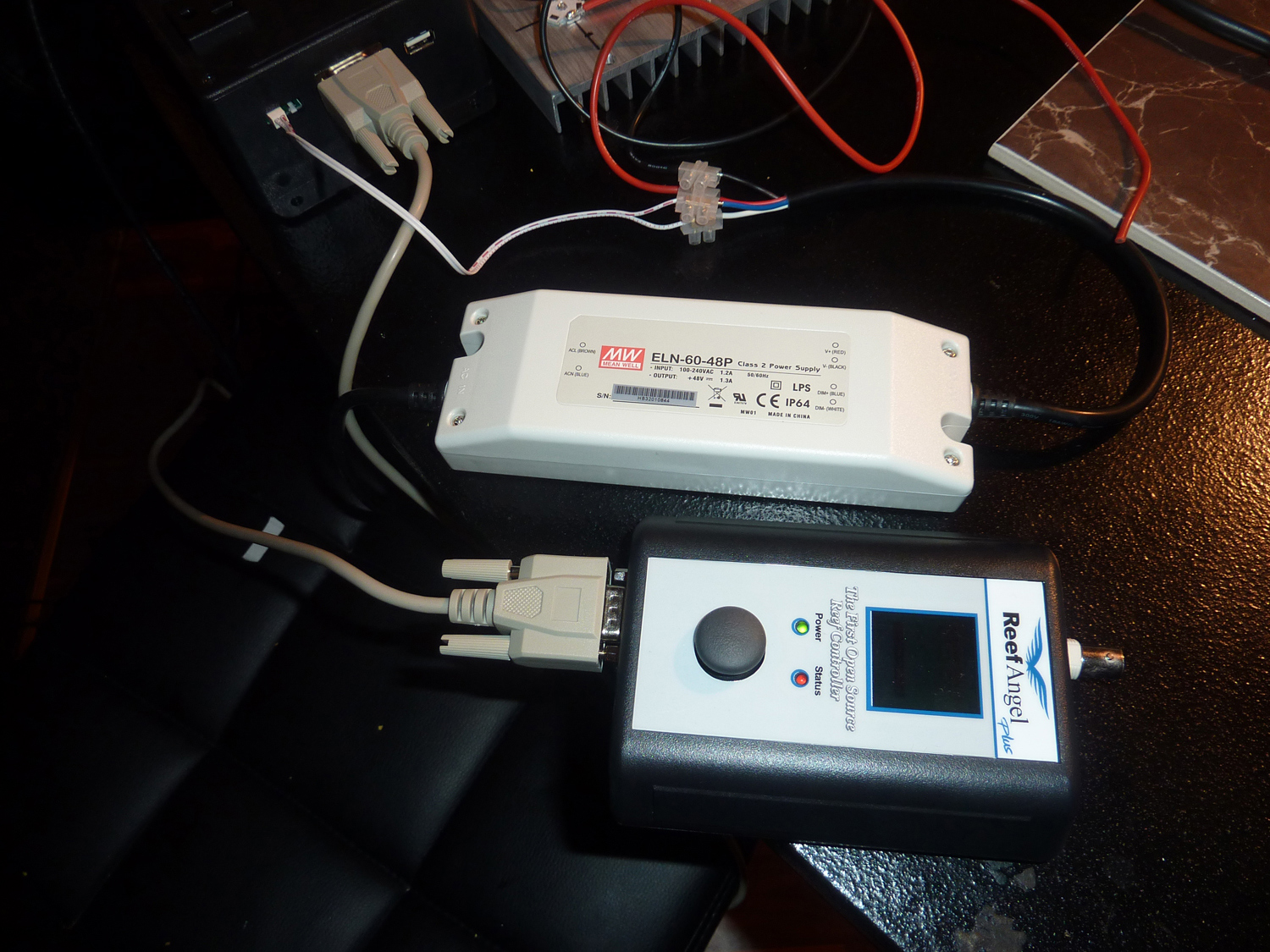

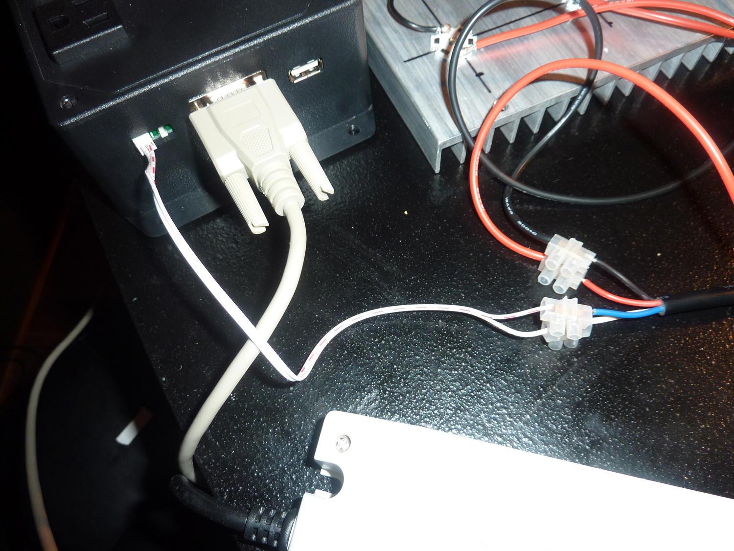

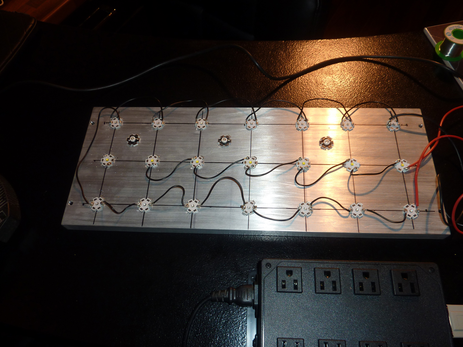

Here are the pics. Only the outer 14 LEDS are being used. The inner 7 are daylights and not finished. The last 3 are violets.

- Relay box attached to ELN 60 48P

- LEDs, outer only in series

Dimmer looks correct, can't tell the markings on the LED's, but since they flash on power down I think the polarity is OK on them.
Lets see your code.
Lets see your code.

I was eyeing those splicers you were using. I bet something was going on there.
