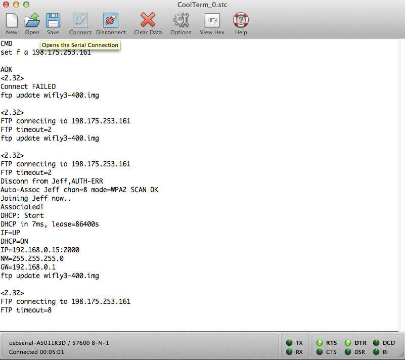

Re: Wifi firmware update problem
I did what you suggested
Give it another shot...
The first 2 looks like the wifi wasn't connected...
The AUTH-ERR shown in the log tells that the wifi was not connected properly.
The 3rd one was issued mid way into the authentication process.
