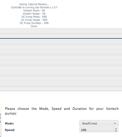

Hey guys,
i seem to be having an issue with my RF module.
I have just set it up from scratch again for use with my new tank (had it running previously on another tank)
On my home screen, i have a line that displays the current Vtech mode.
So i went to the portal and changed from constant to ReefCrest and speed to 100%,on my homescreen it shows that Vtech is in ReefCrest, but the modules light is still green and i dont think feel like the speed has changed?
What steps can i take to troubleshoot?

Well, I have checked on my iPhone in the memory settings.
Vortech mode is set to 2, speed 100 and duration 10 (what is the duration all about? I've never seen it before)
BUT, I tried to unplug the rf module and reconnect to see if the light would change colours and then I plugged it back in, I just get a red light flashing for about a second and then nothing.
I also tried to unplug my reefangel from the mains and turn back on, same situation.
What is going on? I havent dropped the module or damaged it in any way - it's been in storage for the last month.....
Heeeeeeeelp

So based on the iPhone app thread:
I'm assuming my iPhone test was meaninglesslnevo wrote:Yes, just tested again... tried changing RFmode, standard light on minutes, and a custom byte. I get Mem updated 3x and when I reload the same values are there. I checked directly on the controller and no change to the memory locations...
- lnevo
- Posts: 5422
Re: RF Module issues
From my tests I would say so... try changing them directly through the http interface.
THe other thing I would say is load the Vortech setup code and re-setup the master/slave relationships.

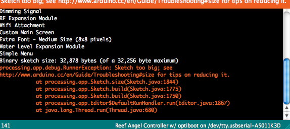

Your code doesn't have the RF enabled.
When you compile, you will see that Vortech is not a feature in the list.
You need this either in setup() or loop():
ReefAngel.RF.UseMemory=true;

I just tried to add in this code, but am now getting a Sketch too big error?rimai wrote:Your code doesn't have the RF enabled.
You need this either in setup() or loop():Code: Select all

I wont actually be needing the LED values to be displayed at all (on screen or through web/portal etc), can I safely remove these lines from my code?
in DrawCustomMain:
and
Otherwise how would I go about removing the LED's from the equation (which would probably give me more memory to use, right?)
#define DisplayLEDPWMCode: Select all
