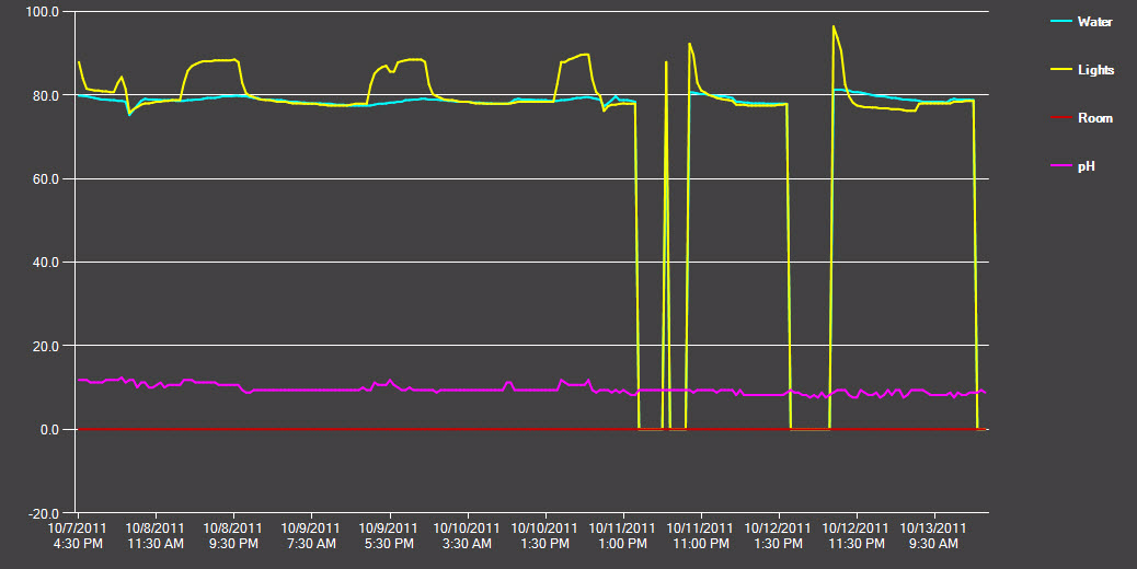

Here is a screen shot of the Client, you can see the multiple drops since Monday.
- temp probe.jpg (96.19 KiB) Viewed 5040 times

This just happened again, and it coincided with my metal halides coming on. They come on at 3pm, and as soon as they did, I got warnings about temperature. Checked the client and the temp gauges are at 0.
Wonder why this all of a sudden popped up.

Just wanted to give an update to this.
I talked to rimai in PM about this and he felt it was due to my Icecap ballasts. For some reason, when the MHs came on, the temp sensors were erroring out.
He sent me a new modified board right away. I got the board, put it in the controller and re-uploaded my PDE.
I'm happy to say, it's now 3:18pm EST, 18 minutes after my MHs came on, and my temp probes are still reading appropriately.
Thanks a lot rimai!
