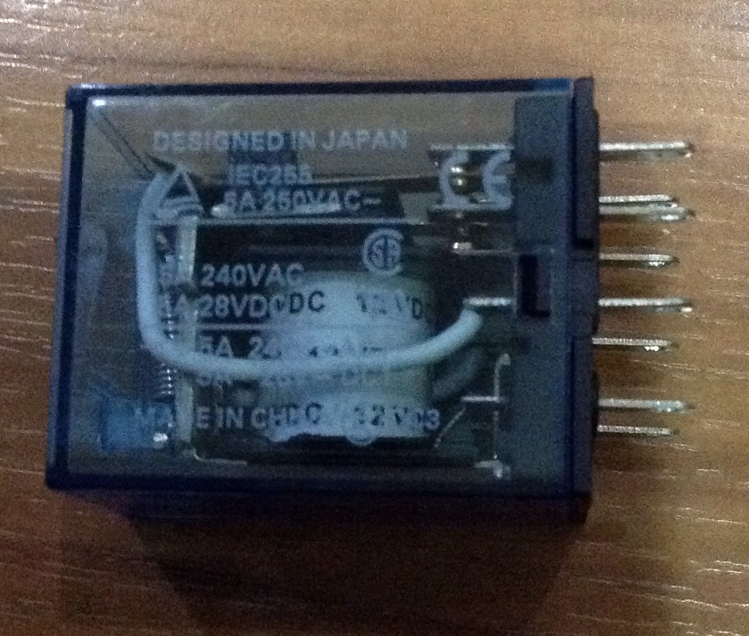

Does anyone know how to wire up a DPDT relay (double pole double throw relay) with battery to run a Jebao wavemaker, when the mains power fails? I have a OMRON relay.

Use a power supply to act as source to the coils. I can't read what voltage your coils are. Just make sure you match the same voltage. It looks to be a 12VDC coil.

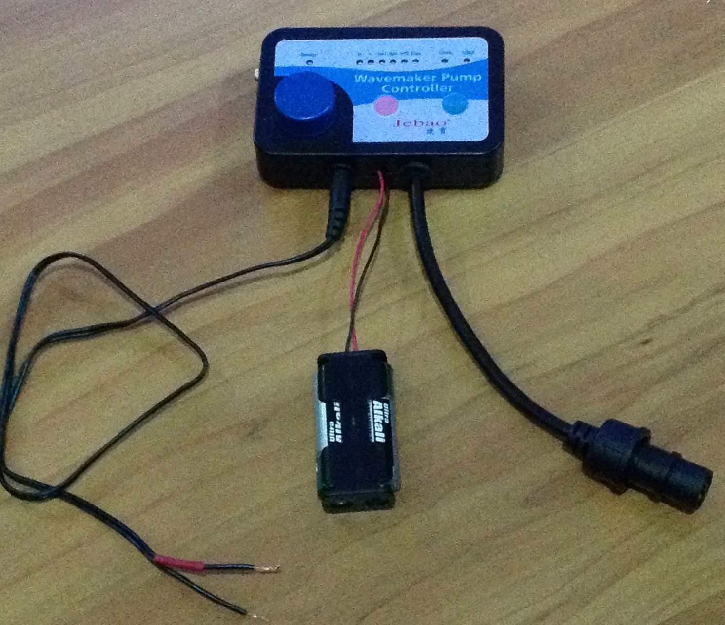

The Jebao wavemaker runs on 12VDC supply. I have a busted Jebao controller ( no led lights and it doesn't turn the pump). I connected a 3 volt battery to the VA and negative wires. Connected to the pump and power supply and the controller works. I connected the controller and power supply to the DPDT relay and it works.

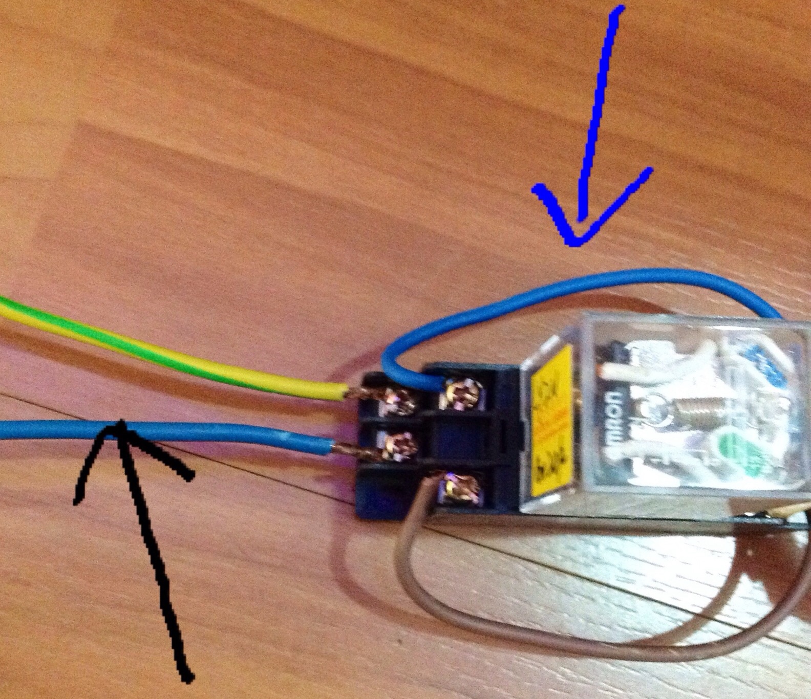

I got hold of a 24V DPDT relay and hooked it up to a 24V power supply. As Roberto pointed out I just used one power supply to energize the coil as well as power the Jebao wavemaker. The battery supply came from a solar charger giving out 12V supply. I tested the whole setup and it works.
The blue arrows are from the 24V power supply. The black arrow is from the solar charger (12V).

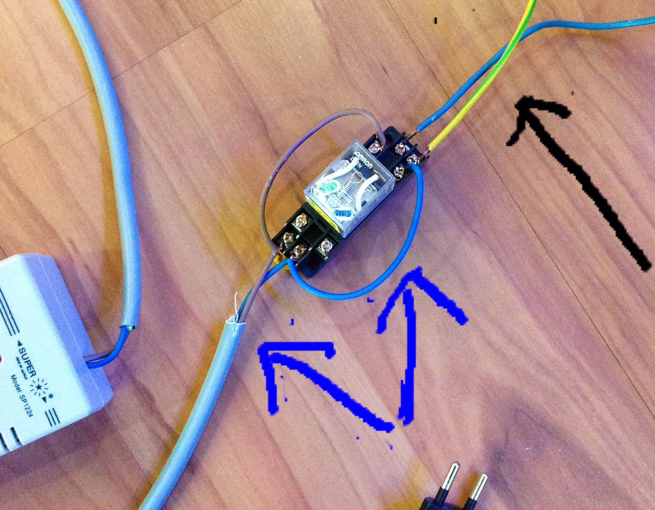

Blue arrow from 24V power supply. Black arrow from solar charger (battery -12V)

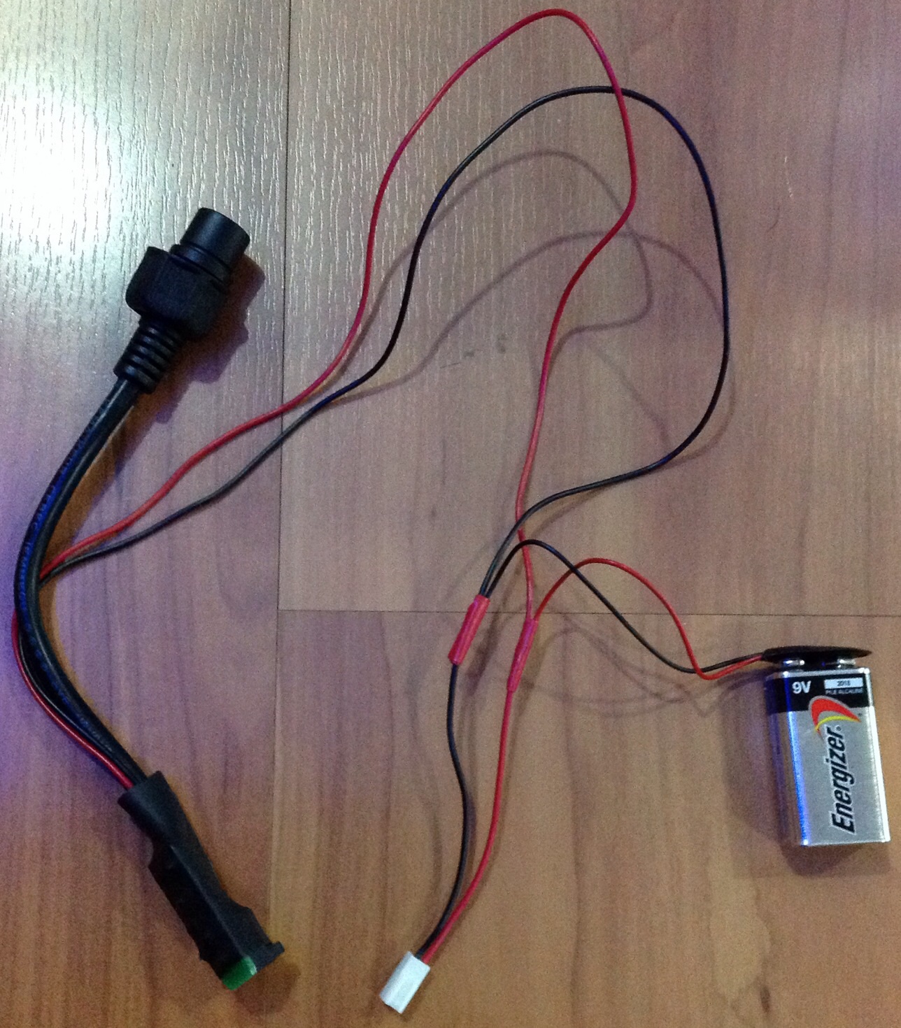

I made this modification to the Jebao harness. Connected a 9V battery to the harness. When connected to the wavemaker without going through the RA unit the wavemaker works. When connected to the RA unit the battery seems to take over and the pump just spins without any wave forms. (At least it moves water). If I disconnect the battery then the RA unit takes over. Now to find a way to connect the battery only when the main power outage occurs and pump runs on battery backup (using the DPDT relay). I think I have to put a relay in between the battery and the harness.
