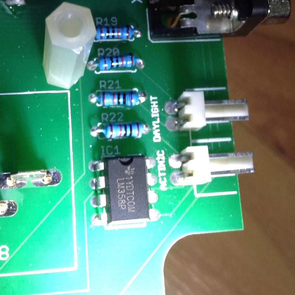

That looks like your chip may have gone bad.
If you open the relay box, you will see a LM341 chip. You must replace that one.

rimai wrote:That looks like your chip may have gone bad.
Thanks Roberto.

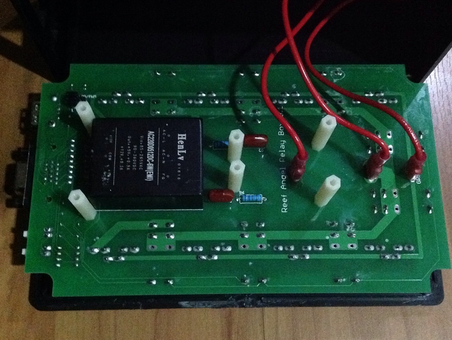

Where do I locate the chip? Is it on the other side of the circuit board? How do I access the other side as there are no screws to take out.
The only chip that I can see is LM358P. Is that what I have to replace?
Thanks Roberto.
Never mind. I managed to take the circuit board out from the main cover.

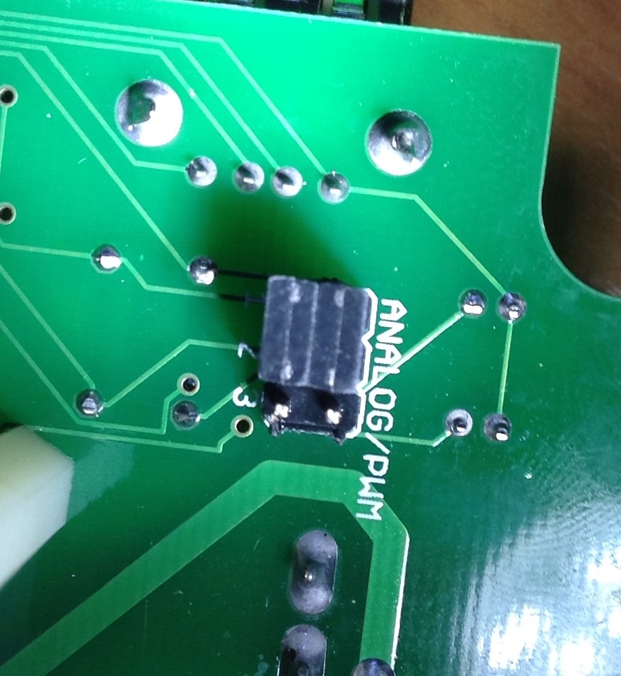

The jumpers are connected to analog. Can I change it to PWM to run the Jebao wavemakers?

davaraj wrote:http://my.element14.com/fairchild-semic ... atch=rel_1
Is this the correct chip?
So this must be the correct chip now.
http://my.element14.com/jsp/search/prod ... 4177583160

The Jabeo's can run as PWM or Analog. You can try changing to PWM to see if that functionality still works... not sure what the chip that Roberto is asking to replace does...
Re: Actinic channel not working
Yeah, that one. Sorry for the wrong chip. I was typing on the road :(
The markings are inverted. So, Analog is not really analog. It is in fact PWM.

rimai wrote:Yeah, that one. Sorry for the wrong chip. I was typing on the road :(
Thanks Roberto,
I changed the chip for a new one and now both dimming channels are working as before.
