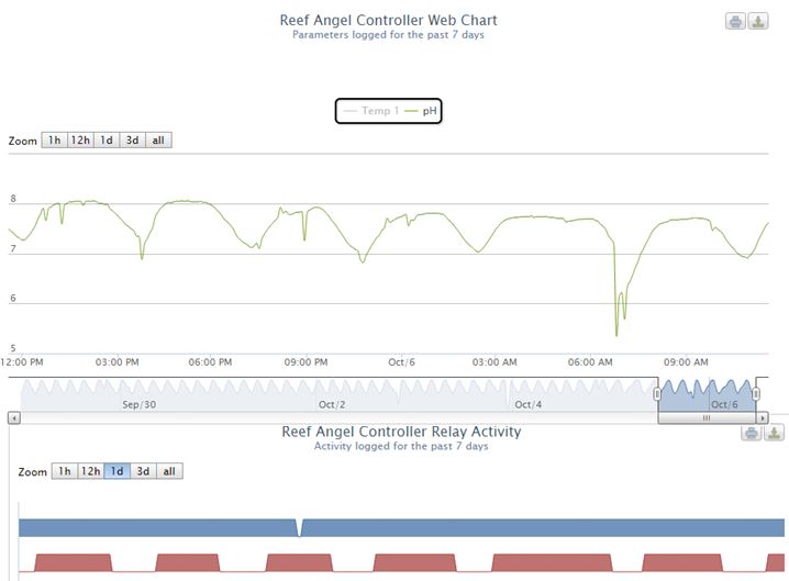

My pH has been very buggy recently. I even replaced my pH probe since it was over 1 year old. I recieved a new probe from Roberto, calibrated it with some calibration fluids that I bought off Amazon and they put the probe in the tank on Saturday. See the attached, I think my heaters are having some impact on the reading.
The relay output below is the heaters, which is strange since the Ph probe is upstairs in the DT while the heaters are both in the basement sump. I figured they should be somewhat isolated systems but I guess that there is a solid column of water in both the siphon and return while the main pump is running.
I'll try moving the pH probe around, I'll try the overflow next. I want to nail this down soon since my calcium reactor arrives this week!

Your heater may have a voltage leak. That will cause a false low pH reading.

cosmith71 wrote:Your heater may have a voltage leak. That will cause a false low pH reading.
Both heaters are completely submerged. I'll relocate them to a vertical position with only the glass parts covered in water and see what happens.

Check all of your temp probes and float switches if you use them. They can leak voltage and cause this as well.

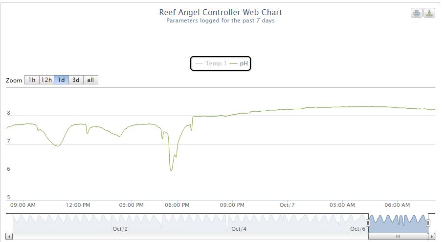

I was able to pinpoint the problem to the High limit float switch. When I disconnected it at the head unit the pH stabilized to 7.97 and has been sitting there since. Image

Behaved as expected overnight. The slight rise overnight is due to a kalkwasser drip.
