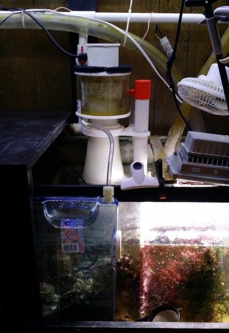

Water jug from Walmart, float switch I had lying around, and a bit of carbon pad for stink control.

I have similar thing.
Can I give you an advice?
Get a longer stem float switch or try to mount it a little lower into the container or maybe place the container inside a tub.
Not that it will happen, but I had it happen once to me.
My skimmer was dialed wrong and I was getting a lot of water going to the container. By the time the float sensed, there was enough water in the cup and inside the line to overflow the container.
I woke up 3 in the morning with my rope leak detector beeping :)
Re: DIY Skimmate Locker on the Cheap
Posted: Mon Feb 16, 2015 5:45 pm
by cosmith71
Good idea. I hadn't thought of that.

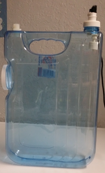

I have the same container, but I am using it horizontally and punched holes through the white cap.
I will post a picture later.

I haven't had to empty a full container yet, but I'm hoping to use the lever on the bottom.
Photo attached.
Posted: Thu Jun 16, 2016 4:08 pm
by cosmith71
Looks great!
