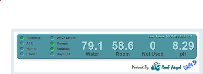

The wifi dropped at 9:25 pm according to my web banner when I looked at it this morning.
I tried to ping the wifi and could not get a reply. I was surprised that the wifi had not come back at 6am when the RA should have rebooted using the code you gave me (see above).
I had to hard reboot the system by un-plugging and re-plugging into the mains socket.
You will see from the banner that the room temperature was 58.6. On previous times when the wifi has dropped the room has been cold. When we go away for example we turn down the heating to around 45f to stop the pipes freezing.
