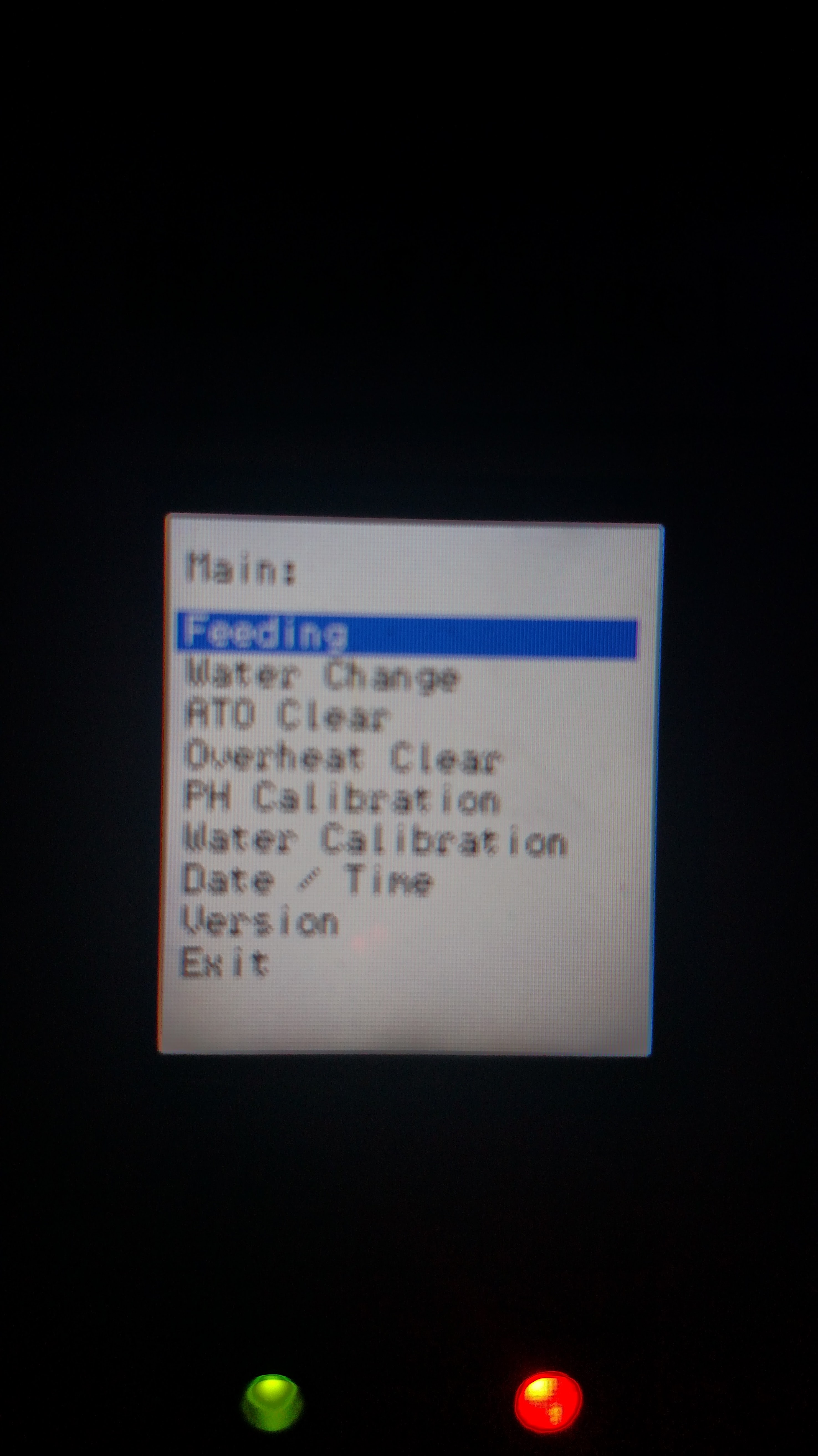

I have 2 controllers in my house.
Ones is being used on my main system (350 gallon system) and the other one is on the garage on my frag system.
I noticed one day after uploading code to the frag tank controller, I had a cool new menu.
It let me adjust the PWM settings, and the heater settings, and choose lights on from the controller.I remember being able to do this originally a few years ago.
But the other controller has the 2014 menu all the way thru. No lights on/lights off menu.
My question is, what about the two different codes is making it do that?
And how do I get the Lights on menu on my main system?
I'll post both codes in separate replies in just a moment.

Picture of Menu

Picture of Menu
Re: Two Controllers with Two Different Menus
The only difference I see is this line:
    ReefAngel.AddStandardMenu();  // Add Standard Menu
It's in the frag tank code, but not in the main system code.
I get that screen when I push in on the joystick.

cosmith71 wrote:The only difference I see is this line:
The wizard did both codes for me, minus some small custom code.
I wonder why it loaded on one, and not the other?
