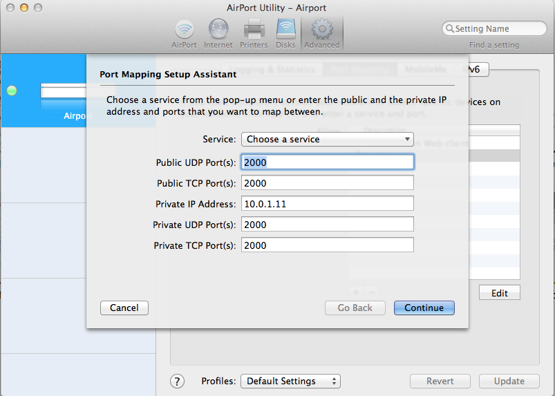

wolfador wrote:
I will grab some screenshots tonight.
sorry a bit late.
My RA is configured for 10.0.1.11
- Screen Shot 2012-01-22 at 5.22.52 PM.png (132.4 KiB) Viewed 8589 times
Re: WIFI Port Forwarding problems with Airport Extreme
Thanks for posting that John.
My port forwarding is set up the same as John's. I have checked my external IP address the last few days and it has stayed the same.
However, I cannot connect through my iphone of through http://99.67.237.227:2000/wifi. I can connect through 10.0.1.2:2000 wifi.
