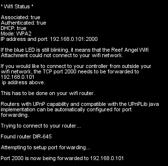

This is where I’m at
To be able to connect remotely to your controller from outside your wifi network, you will need to setup port forwarding on your router. The TCP port you need to forward to your wifi attachment is port 2000.
Most recent routers have UPnP capability. This utility will try to setup port forwarding automatically on any UPnP capable router that is compatible with the UPnPLib Java.
If the utility is successful on setting up port forwarding on your router, you will get a message below
http://forum.reefangel.com/download/file.php?id=343
Mine stays trying to connect to you router

Re: WiFi help
This attachment you sent shows your wifi attachment using ip address 192.168.0.101 and not 10.1.0.2.
