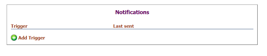

Re: RA+ to RA*
Posted: Thu Mar 22, 2018 10:19 am
by riggeek
Here is what I see.
Re: RA+ to RA*
Posted: Thu Mar 22, 2018 10:38 am
Are you getting emails though?
I see it sent an email about 30 minutes ago for salinity less than 32
Re: RA+ to RA*
Posted: Thu Mar 22, 2018 11:41 am
by riggeek
I am getting emails. So they are active, I just can not see them.
Re: RA+ to RA*
Posted: Thu Mar 22, 2018 12:20 pm
Weird. Did you also try another browser?
Re: RA+ to RA*
Posted: Thu Mar 22, 2018 12:25 pm
by riggeek
Tried chrome, and Internet Explorer, on 2 different computers
