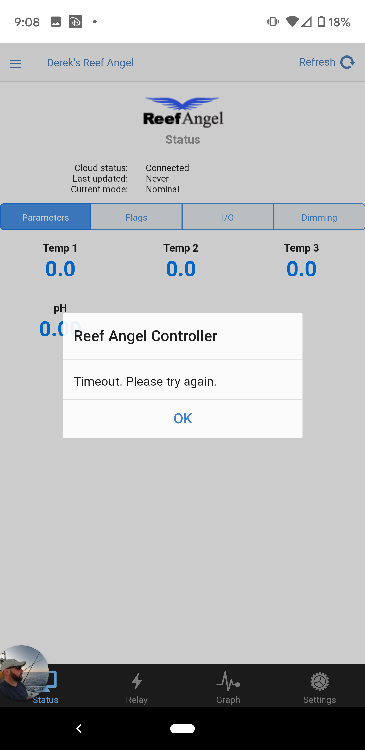

Uapp Graph shows no Data to display always.

i need to push my code back asap as tank is down....
Re: Uapp Graph shows no Data to display always.
This time it went through.
So definitely something on your code is causing that.
I just don't know what it is....

I restored to the original code ony original account since I needed the tank running and we ruled out an account.
The thing is it was all generated by the web wizard... And nothing intense either
I know.
The only way to find out which one is the offending line is trial and error.
Add a few lines at a time and check if it is causing the failure.
The first thing I would try first though is removing just the labels at the bottom. Leave the RA_STRING ones.

Pushed code. Tanks running and cloud is disconnected... It worked before all of this.....

Cloud won't work after re pushing the code you sent over. Network plugged in and all...
The code I sent had the encrypted password for the test username we were using.
If you are using your username, you have to use the correct encrypted password on field RA_STRING1
The string for your password is this RA_STRING1=U2FsdGVkX18SRGs3W6Nho4tbkPQm9kNx1zw1++/r4LSB5npUkT/wWfcMeCtcWzAq

So I need to load my original code then? That I have saved? If so I can do that tomorrow
Yes, start with your original code while logged in with your username and just remove the RA_LABEL strings at the end.
Let's see if that does it.

That then removes the labels from the unit doesnt it?
It will, but at least we will find out if they are the cause.
We can work on something then.

Done! I'm running serial monitor now.

It's not the labels

Is rastring2 and rastring3 supposed to be there with a NULL value?
Hum... We will have to go one chunk at a time. :(

I removed the buzzer and the heater.
Actually, I noticed the code has some extra stuff you don't have.....
I removed the extra relay box references that you don't have just in case.
Uploading now
SouthernReefer
Posts: 152
Joined: Thu Nov 14, 2019 2:51 pm

ReefAngel.StandardLights( Box1_Port8,22,0,10,0 );
ReefAngel.Network.Cloud();
ReefAngel.ShowTouchInterface();
// RA_STRING1=U2FsdGVkX18SRGs3W6Nho4tbkPQm9kNx1zw1++/r4LSB5npUkT/wWfcMeCtcWzAq
// RA_STRING2=null
// RA_STRING3=null
No Dice
Content-Length: 311
<!DOCTYPE HTML PUBLIC "-//W3C//DTD HTML 4.01//EN""http://www.w3.org/TR/html4/strict.dtd">
<HTML><HEAD><TITLE>Bad Request</TITLE>
<META HTTP-EQUIV="Content-Type" Content="text/html; charset=us-ascii"></HEAD>
<BODY><h2>Bad Request</h2>
<hr><p>HTTP Error 400. The request is badly formed.</p>
</BODY></HTML>

Uploaded and now I'm running serial monitor
SouthernReefer
Posts: 152
Post by SouthernReefer »
rimai wrote:Did you catch the updated one after that?
Still No Dice
RA Init
SPI Init
LCD Init
Network Init
Touch Init
SD Found: 1
SD Init
192.168.1.19
MQTT Connecting...
MQTT failed
MQTT Connecting...
MQTT succeeded
Portal Call
Channel 5Data Sent
Channel 5HTTP/1.1 400 Bad Request
Content-Type: text/html; charset=us-ascii
Server: Microsoft-HTTPAPI/2.0
Date: Sat, 31 Oct 2020 03:58:34 GMT
Connection: close
Content-Length: 311
</BODY></HTML>
ÿDisconnected
Channel 5Connecting...
Channel 5Connected
Date: Sat, 31 Oct 2020 03:58:35 GMT
Connection: close
Content-Length: 339
Data: 339
Channel 5Header: 0
Channel 5Disconnected
Channel 5MQTT Connecting...
Channel 5MQTT succeeded
Channel 5

Cloud seems to keep cleaning my controller frrom UApp now. Is that likely intentional?

Ok I'll push the original code so at least things are there for now until tomorrow
SouthernReefer
Posts: 152
rimai wrote:Damn. Let's resume tomorrow. I have to put my daughter to bed.
Soooo next steps? Pushed my original code last night and cloud is broken...
