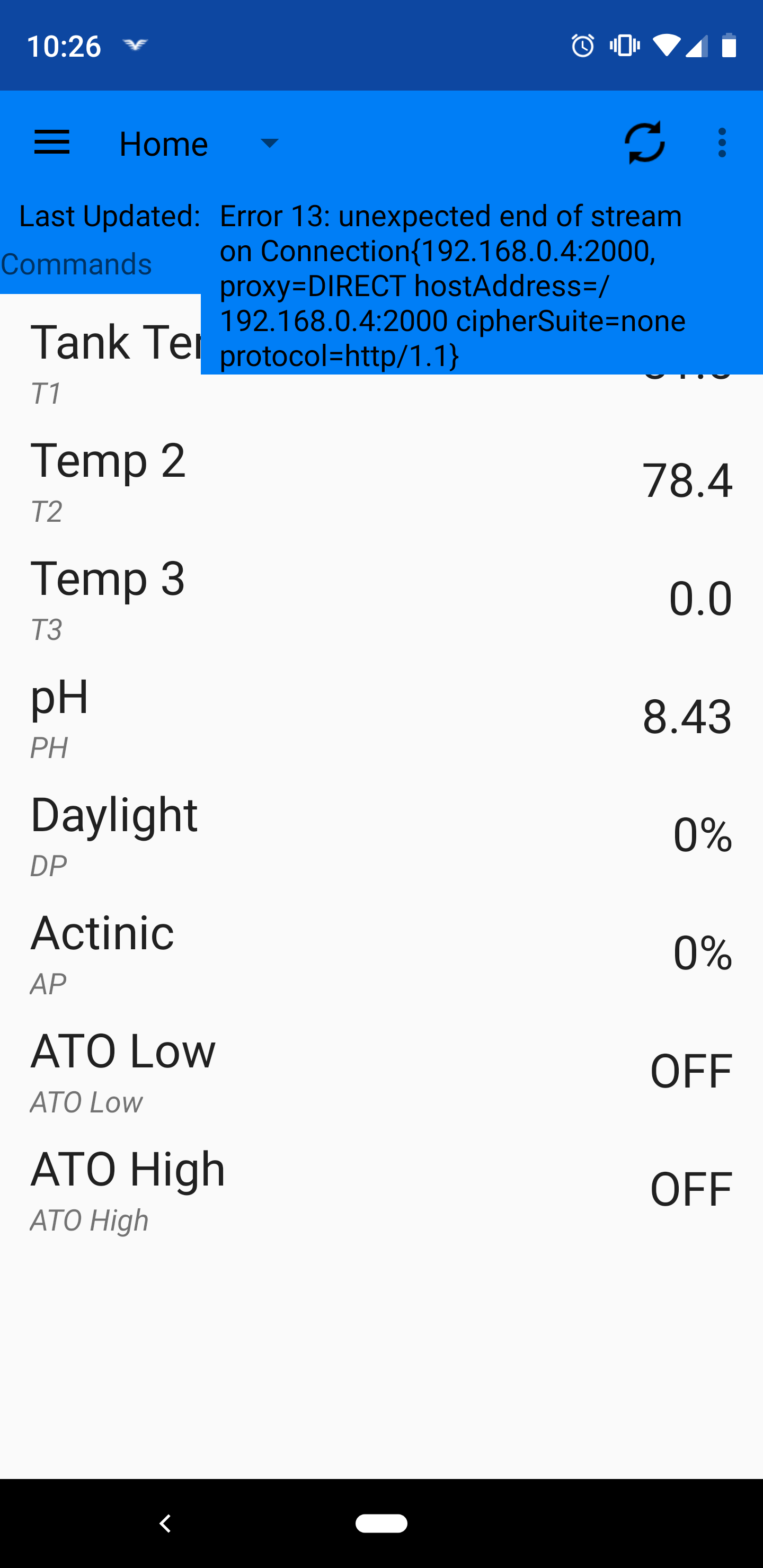

Jun 10, 2019 9:08:57 PM
Profile: Home
Host: 192.168.0.2:2000
User ID: knapp870
IOException
java.io.IOException: unexpected end of stream on Connection{192.168.0.2:2000, proxy=DIRECT hostAddress=/192.168.0.2:2000 cipherSuite=none protocol=http/1.1}

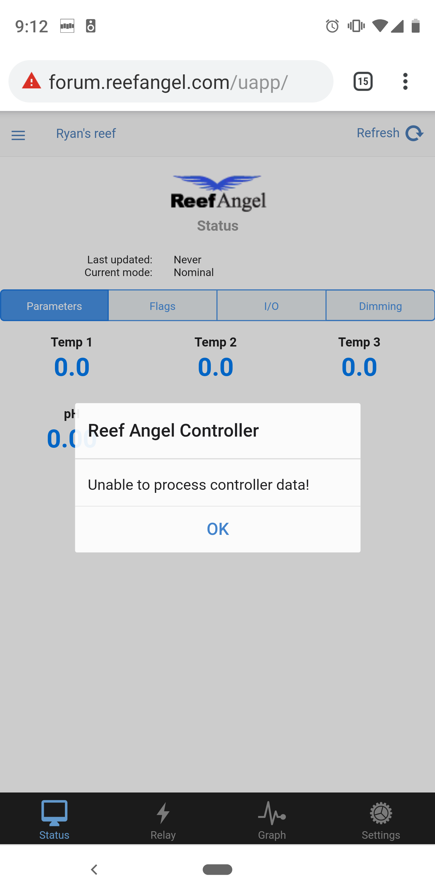

Re: Unexpected end of stream
Screenshot

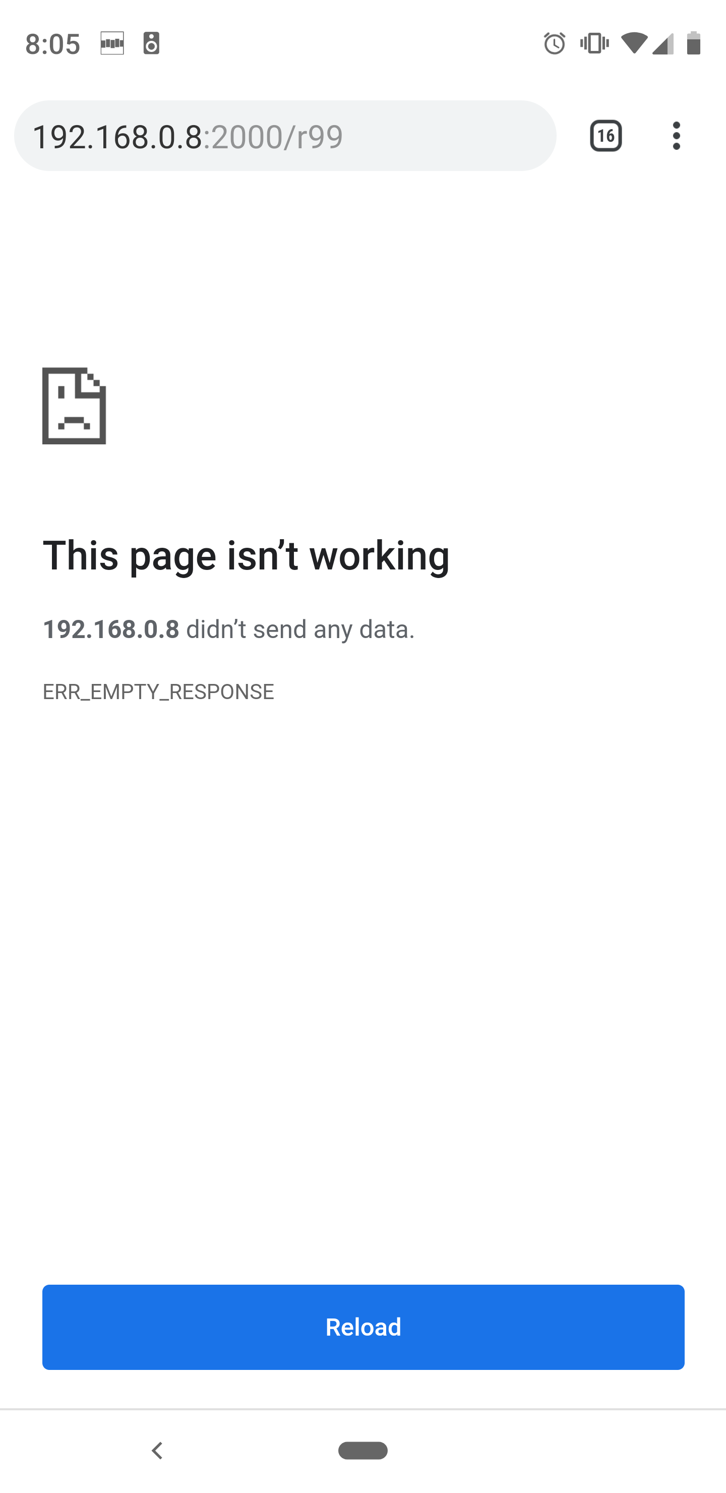

What do you get if you connect to the controller?
http://ipaddress:2000/r99
knapp870
- Posts: 39
- Joined: Mon Apr 16, 2012 10:52 am
- Location: Kansas City, MO
Says page did not send any data
The log you showed earlier said your ip address was 192.168.0.2.
Did anything change?
