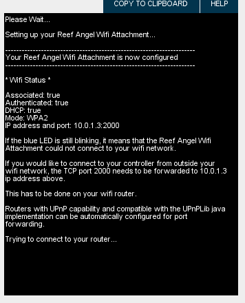

No. it just sits on Trying to connect to router. and the light is a slow green

Looks like the wifi setup has received and IP address from your router. It's the 10.whatever:2000.
It may not me able to setup port forwarding which you may have to do yourself.

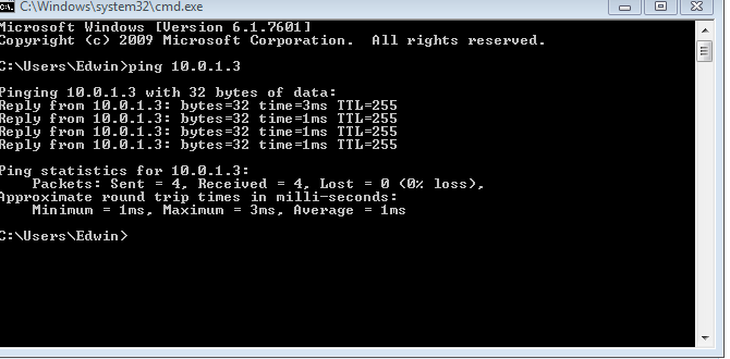

rimai wrote:Are you sure you are in the same network?
Can you ping the module?
Roberto, yes i can ping it....
and the portal still says an unreachable port, and the forwarding wizard says its open...

Maybe an ip conflict? May need to check the port settings on the module. All i can think of...
Re: Wifi issue
How do i do that?lnevo wrote:Maybe an ip conflict? May need to check the port settings on the module. All i can think of...
Wifi issue
Serial terminal program.. Command is 'get e' the manual should have details on setting up the session. For an ip conflict. Disconnect the module and try pinging again.
