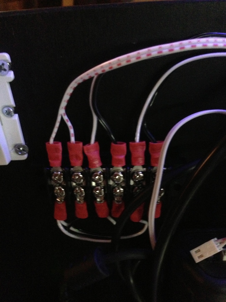

So I decided I will wire my switches to a barrier strip so I can wire them up in series or parallel. I'm not yet sure how I want to configure this yet and I figure this way I'll have some flexibility. I have the code in place to leave my switches as-is and use the RevereATO functionality to make them behave as if I flipped the magnet on the switches. If I do this, then I can wire them in parallel. If I decide to flip the magnets I'll have to change the wiring to putting them in series. Anyway, when my swabbie and skimmate locker get here I'll be loading my new code and changing the wiring. Will have a lot of testing to do for sure... I've made a lot of changes!

Anywhere, here's the wiring I did to have both switches wired in parallel. If it doesn't work out, I can redo the jumpers and wire it up in series.
