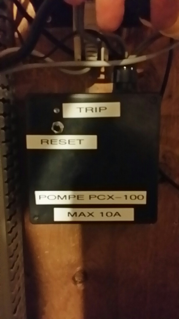

Can Iget help with a code? I have a float switch right now in my aqua on the first floor and my sump is in the basement. when water rise in my aqua because a snail went in my pipe going down. the float switch stop my pump until i'm back and start it again manualy. Right it is the black box you see in the pic doing the job but every time i feed i have to go hit the reset button to re-start the pump
, so i cant use the feed mode!! Now how can i do that with RA?- Attachments
- Set up
- 20141008_144424_resized.jpg (178.91 KiB) Viewed 9610 times

Try this:
This assumes you are using the LowATO port for your float switch and Port8 for your return pump.
If the float switch is triggered, it will override Port8 to Off and you can clear the override with the Portal or smartphone app after you inspect and know what is wrong.
if (ReefAngel.LowATO.IsActive()) ReefAngel.Relay.Override(Port8,0);
