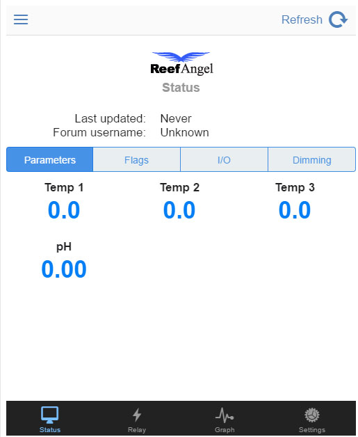

'Lo - is the internet web portal working?
192.168.0.13:2000/wifi
I add my controller
Then when I click refresh it tells me it is unable to process data..?
Any thoughts?

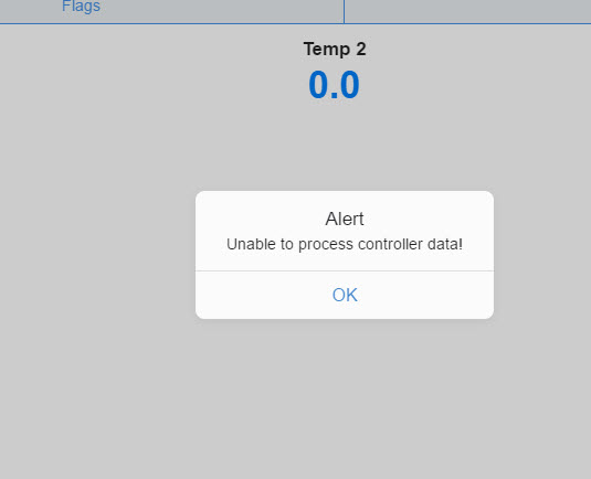

Can you send screenshot?
Smotz
Posts: 401
Location: CT, USA
Re: internal web page no longer working?
Post by Smotz »

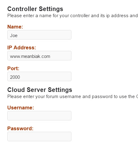

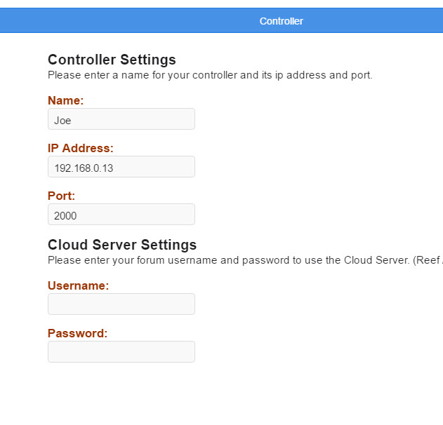

I get the error in ra1.jpg no matter if I enter in the public or private IP
Ok, try this.
If you are using the internal Uapp from ipaddress:2000/wifi, please delete the profile and leave it without any profile.
Refresh that page.
You should see an image without any controller shown in the middle top bar.
Now, hit refresh.
Does it work?
