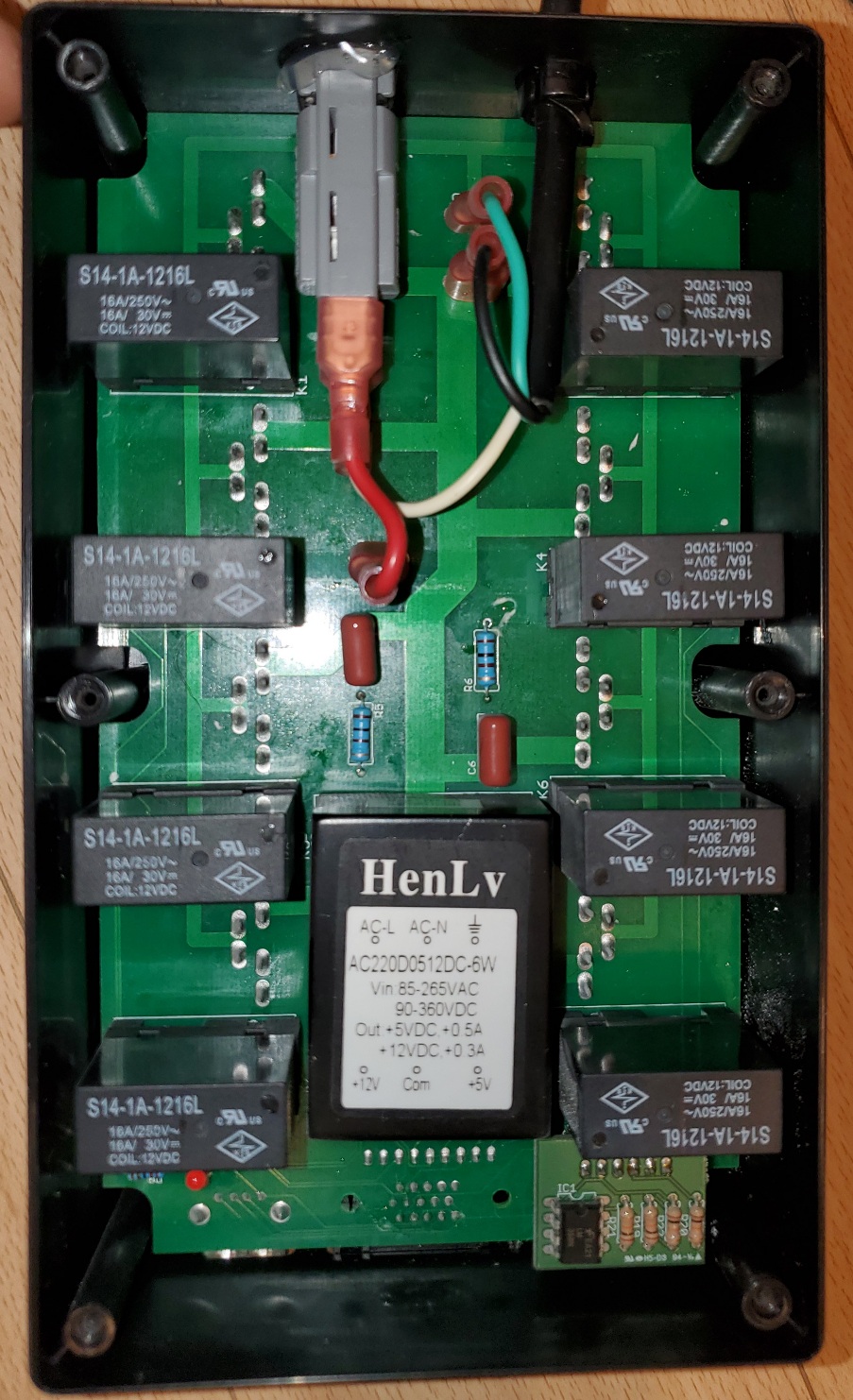

I have old relay box and I have 0-10 PWM booster. Is there an easy way to make it 0-10 Analog? Maybe a simple replacement of the 0-10 PWM booster to 0-10 Analog booster&converter? Or something that can be put past RA controller to smooth signal to analog before it reaches drivers?
My SB Reef basic light are flickering (I guess due to PWM).
Re: Relay Box with PWM?
Open the relay box and give me the revision written on the board or send a photo.

Post by serhiyi »
There is no version that I can see.
Booster is shown in bottom right corner.
This is the booster I have.
Thanks.
You are going to have to get a new box or make another pcb booster daughter board that has the analog conversion.
