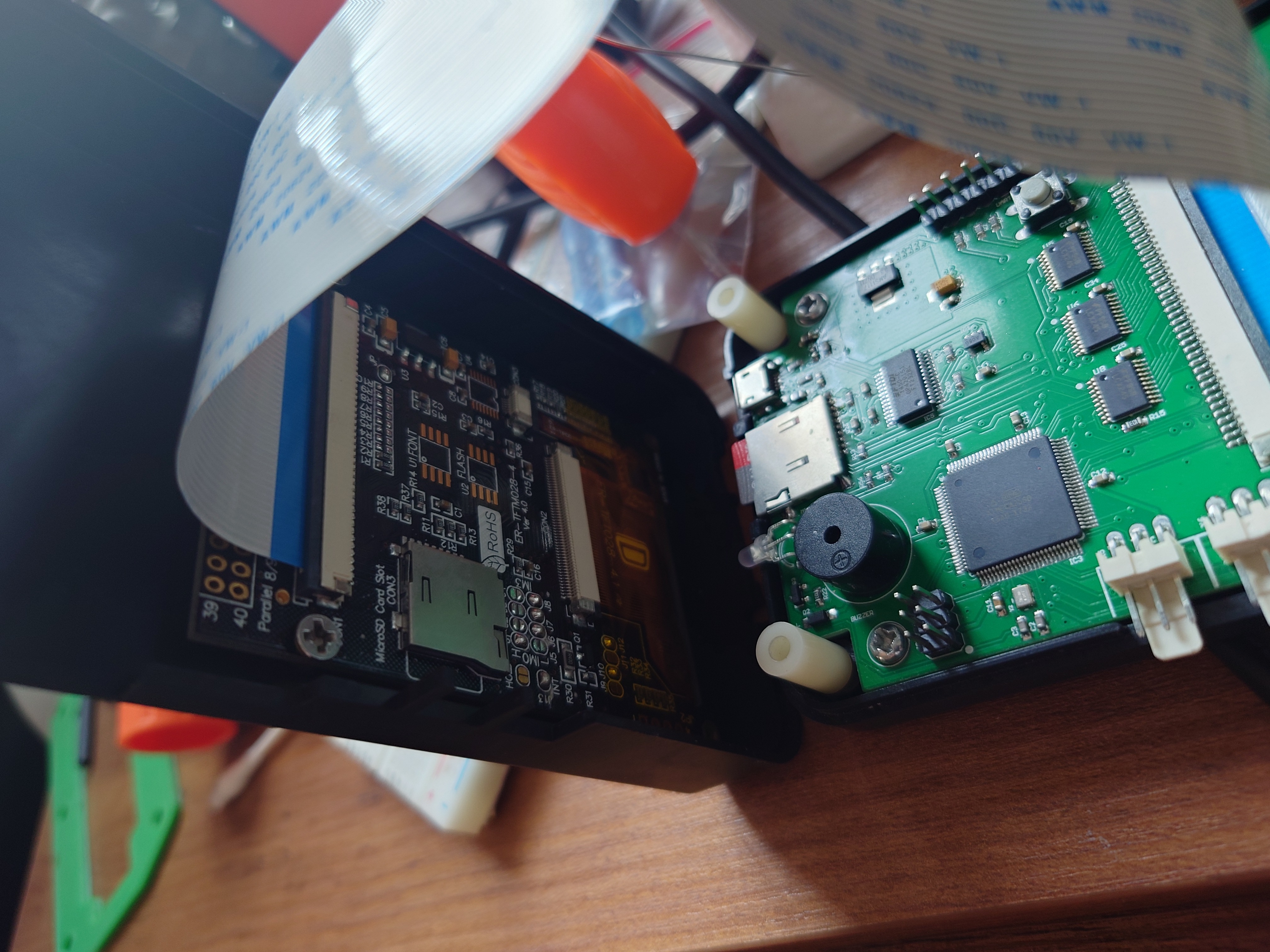

If you open up the Reef Angel Star you'll see 4 pairs of jumpers your lights may need to be changed to analog instead of PWM. Do you know what your old relay box was setup for?
Sincerely, Brennyn
Re: Migration to RA*
I thought it was pwm but now I can't be sure. it been a long time and my memory isn't as good as it used to be! Can you please send me pics of those pins and the ribbon (since the touch screen is still glitchy)? I don't want to be poking around in the wrong places.
Yes I'll attach some photos
- StarScreenRibbon.JPG (2.28 MiB) Viewed 135332 times
- StarJumpers.JPG (2.73 MiB) Viewed 135332 times
Sincerely, Brennyn
You will need some jumpers, you may have some on your old relay box depending on what version you have, if not I can send you some. You place the jumpers on the pins so as you can see on the photo i have 3 jumpers on ANALOG for Daylight, Actinic and Daylight2 so those ports are all Analog. If you had no jumpers on any of the pins then it is PWM by default.
